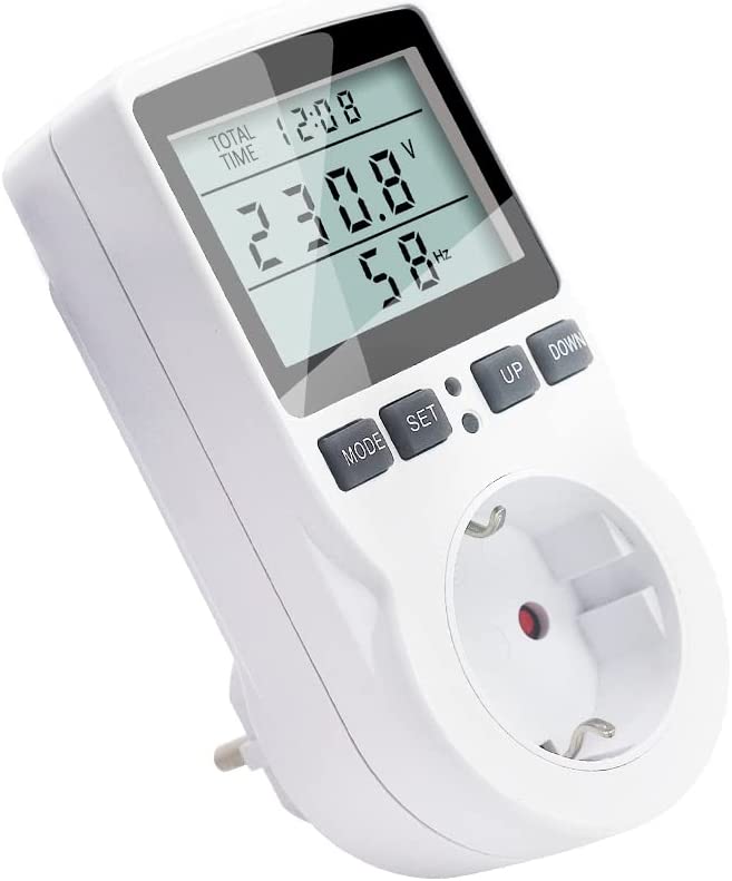

Get one of these cheap but quite usefull power consumption check thingie's you plug between power outlet and the consumer. Often found in your supermarché for around 10€.
Record the consumption over some time, in your "hot" and "cold" setting. The consumption must be higher when everything heats up, the meter gives you an idea how much.
