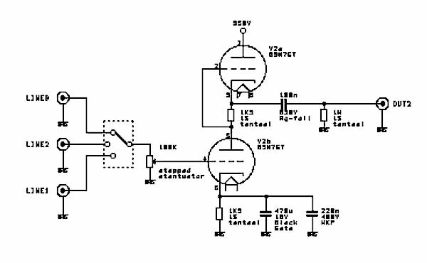

I converted one channel from CF to SRPP according to the attached schematic because no PS changes appeared to be necessary. Unfortunately, the gain is extremely low. With the volume pot near maximum it is barely at a "background music" level. Needless to say the CF channel would be blasting at this setting but I left that channel turned off. Any idea what may be the problem?
TIA
The CF stage has no gain (a gain of almost 1). The SRPP stage should be providing gain.
I assume(?) your preamp was a gain stage followed by the CF. A CF will provide the ability to drive a range of power amps with good distortion figures. If you simply removed it, your earlier gain stage would be under greater loading, but, if you were careful to match it to your power amp, you may like what you hear.
I think the SRPP stage may be unnecessary for this location, but I understand it has a cult following and you might enjoy the sound of it. Ordinarily, I would start with the single triode gain stage (unless there was a reason to do otherwise), and only change it if I didn't like the results.
Thanks so much for your replies. Perhaps my Ra/Rk resistors are off. I used 1K5 as the schematic called for. I'll try something in the 800R range and listen for an improvement.
