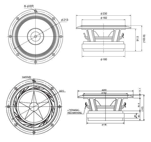

Toto, the plans I downloaded from the Madisound site show two12mm holes spaced 25mm apart for the binding posts. I don`t see any 24mm holes. I`ve built the horns and they are breaking in beautifully. I did not cut holes for binding posts. I cut a hole about 2"x3" and made a plate from MDF with a hole in the center and soldered my speaker wires directly to the driver and eliminated connections on the speaker. This allows me to get inside far enough so I could change things if I wanted and I can get my hand inside the throat from the back or driver hole to access wires.
Thanks to No Xo and Pendergast!
Yes this is my mistake about diameter! The holes are 12 mm!
I post my question because I thought that there is something more special around these holes, related with some specifics in horn design. Now I'm sure that my pair will not have such holes!

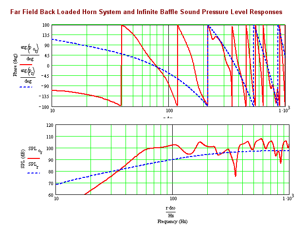

I am using Hornresp to simulate BLH.
I noticed (long time ago) that a bigger (bigger then what would consider common practice) rear chamber is required to calm down FR of BLH, but then I found your article and learned about your design philosophy of BL Horns.
I played with Hornresp on different BLH (for the FE206ES-R) parameters using yours approach (large chamber of around 50L and short horn length of 1m to 2m ) but never got flat FR as you represent.
One exception is when I make the path difference between the direct radiator and the back horn very short (about 10cm to 50cm for horn of ~1.5m, this means that the horn mouth it forward to the driver), here I can get dead flat response.
Could you draw a first guess of a BLH for FE206ES-R using your design concept?
