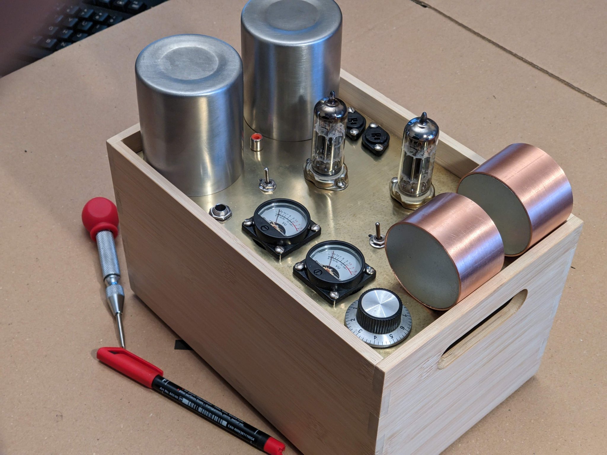

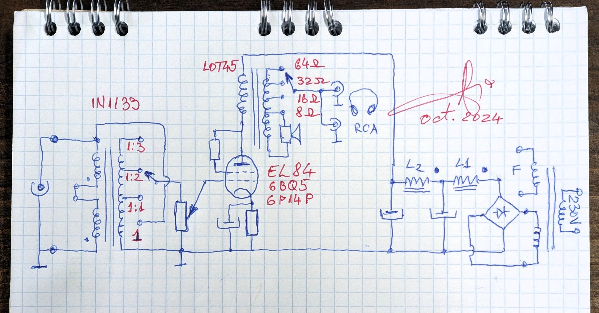

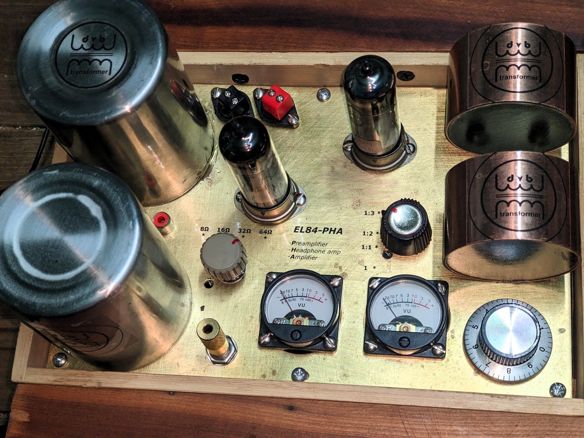

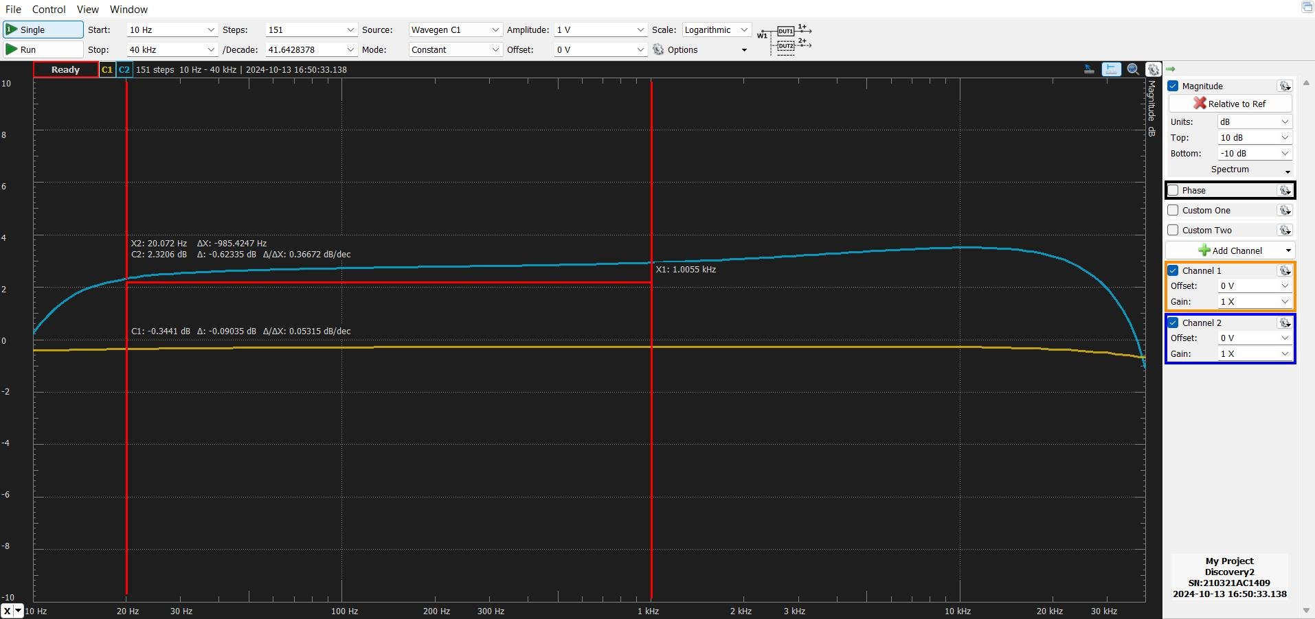

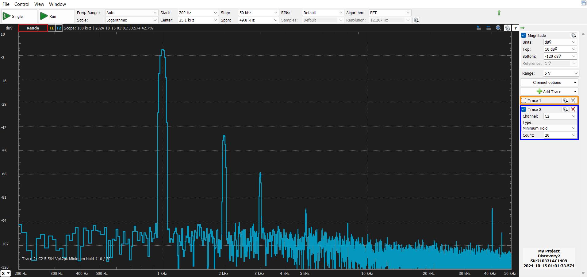

Dorin Bodea Member Joined 2004 facebook.com/profile.php?id=100057288107123 2024-10-16 10:09 am #1 2024-10-16 10:09 am #1 Here's a very simple but highly efficient application of the ubiquitous EL84/6BQ5/6P14P Attachments 8ohm L.jpeg 150.3 KB · Views: 140 600sp.jpeg 184.7 KB · Views: 77 fft 1kHz 2.jpeg 156.6 KB · Views: 92 front.jpg 761.8 KB · Views: 144 sch.jpg 400.6 KB · Views: 145 Reactions: DrowningNotWaving and gerrittube Dorin Bodea Member Joined 2004 facebook.com/profile.php?id=100057288107123 2024-10-16 4:18 pm #2 2024-10-16 4:18 pm #2 here a version with 3 positions switches (instead of 4), same practical Ikea box 🙂 Attachments Ikea.jpg 396.9 KB · Views: 72 You must log in or register to reply here.
