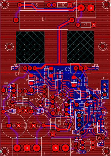

i am slowly understanding all the requirements of a "proper" D amp...
Here is a first PCB layout, done during my lunch time, based on the IRAUDAMP from Internation rectifier applications notes, using the IR2011.
I have removed all the on board protections so i will be able to implement them on another board if required.
i want to achieve just the amp itself, and do some test under prototype mode.
PCB done with PADS.
Dimensions are initialy 2.26 x 3.12 inches, with provisions for a top mounted dissipation bar, or a under type like the ZAP PULSE modules.
what do you think of it?
components locations,...
