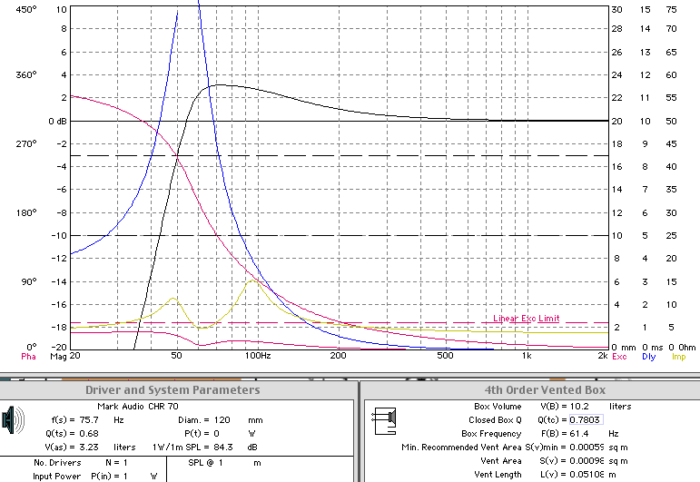

Thank you Dave, I found the appendix. I would put the 2 CHR on the same front panel, widening it to 11" so the two CHRs would barely fit one on top of the other. Is the distance between them important?
With 5mm between the 2 drivers, you can squeeze them into 11". Drivers should be as close as possible, but a bit more height would be good.

How about his for my center 8ohms?
Looks good. What is the volume (can't calculate it from dimensions displayed)
dave
That is sufficient volume.
