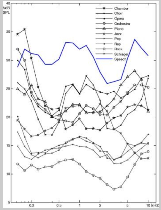

Actually, having a little trouble wrapping my head around the graphs and charts in the paper "Dynamic Range Across Music Genres..." which can be read at Dynamic Range Across Music Genres and the Perception of Dynamic Compression in Hearing-Impaired Listeners
The Delta dB SPL chart (attached) is saying what? Thanks for any assistance!
The vertical scale is dynamic range. Different lines are different genres, and the horizontal scale is frequency.
Rock music is apparently the most compressed across the spectrum, having the smallest dynamic range.
IME, the numbers in the graph are about right. There isn't much music around with a 50dB dynamic range. An orchestra can almost certainly manage that, but the full dynamic swings are never retained in the commercial release.
