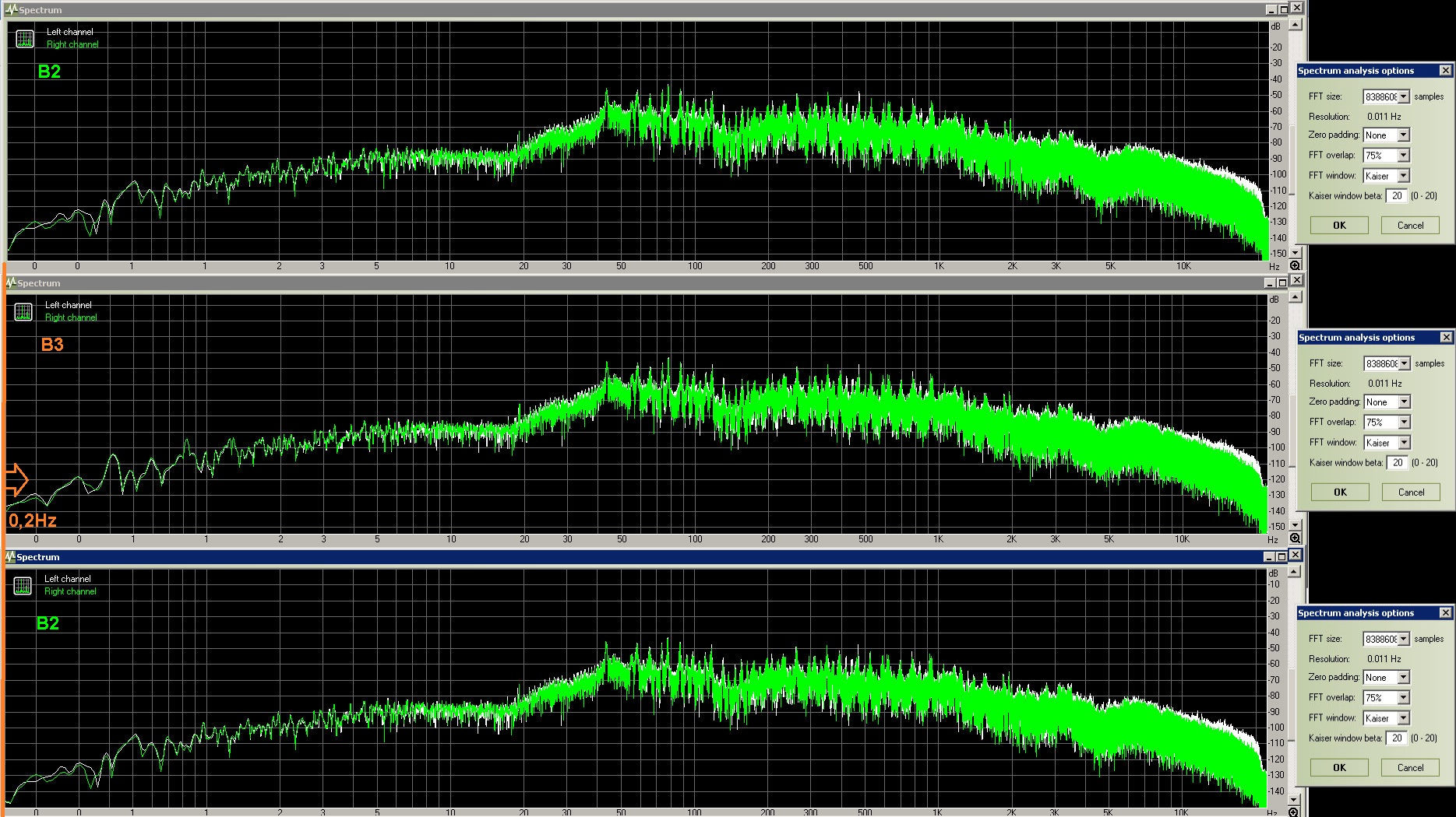

B2,B3,B2=Start-0,2Hz

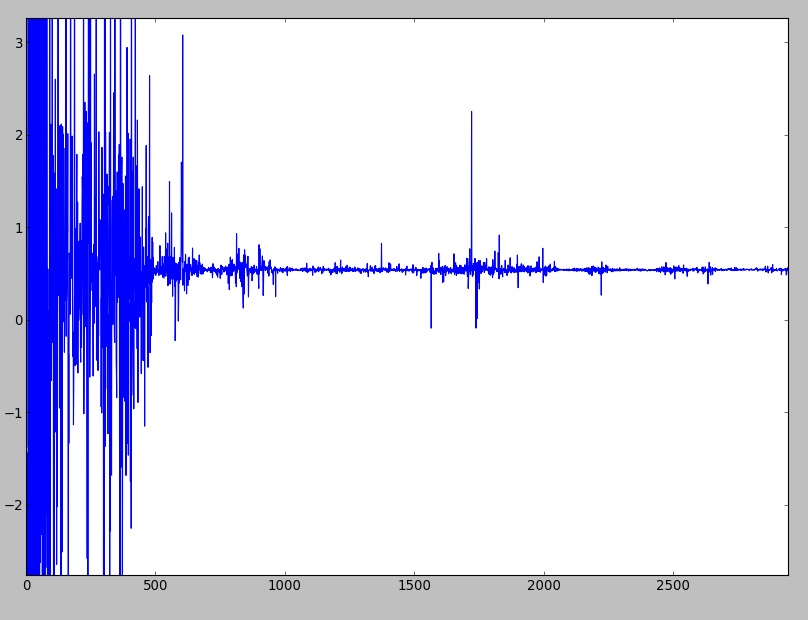

I found this display shows the difference best. This is a plot of 20*log10(|a1|)-20*log10(|a3|) from the first 5sec (220500 samples) so each bin is exactly .2Hz. No windowing or stretching to a log frequency plot which I think obscures the effect. The vertical axis is dB and I think the ~.5dB baseline is visible while the verticle is linear Hz*5 so 500 is 100Hz. I could be that one track has a small amount of distortion in the lows so when compared in dB there could be a large ratio, I don't know. There are stretches with almost perfect match. Moving things around and changing the external noise pickup between tracks could also matter certainly the stuff below 20Hz or so would be mostly LF noise and possibly the A/D has enough 1/f noise to account for all this.
Just food for thought.

...possibly the A/D has enough 1/f noise to account for all this.

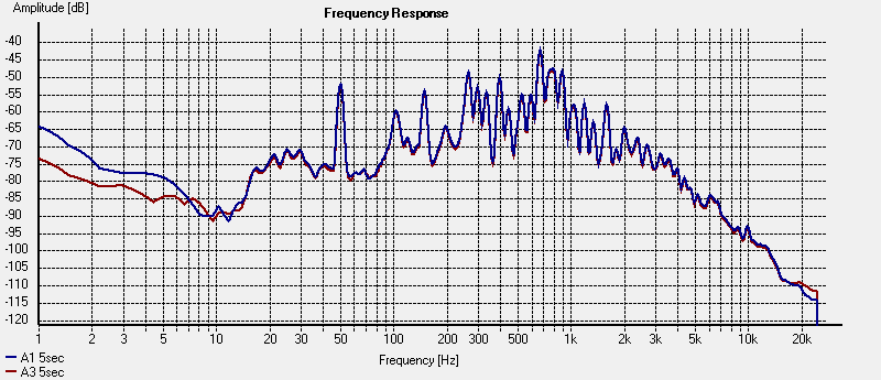

Thanks Scott, that's what I was thinking. A/D noise. I often see this very low end noise in soundcard loop tests.
Below is what I found in the beginning 5 seconds. Analysis done in Audacity @ 65K, exported and plotted in HOLMImpulse to compare. 1/12 octave smoothing.
