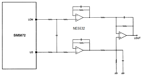

Adjust 120R to get near -2dB at 20KHz and make sure they are the same value.
Yes, in pretty much all situations, you have to cut the tracks.

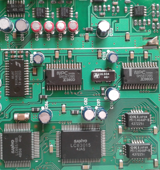

Thanks. I have consulted the CS4362 pcb and the track and size are even smaller than I could remember. Impossible for my eyes and tools.
Tried to find other candidates. Haven't checked/searched the pdf but I found two SM5872 and PCM69AP. The former might not be suitable as I think they are "pure" DAC. The latter is I think too lowly, one bit or something, but it looks simple and easy to work with.
Another candidate is PCM1710u. Three chips on board. The chip is big but the trace and other components are as small as CS4362 pcb, so no go.
SM5872 is suitable!
The SM5872 is very suitable for this approach. No tracks should be cut. As if the circuit has already implemented the same idea as Joe's.
