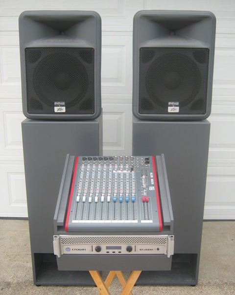

PV10s/12s are great...
Just can't take much power below 60Hz. If your taste in music includes the
modern stuff, and you want it loud, you'll need some help. The problem is
that the PV10's/12's don't move far enough
I've done several Tapped Horns, and my current PA uses PV12's above 100Hz
elevated two feet above the subs. I'm putting 250 watts thru each PV12 and
400 watts thru each sub.
