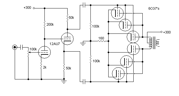

This design could be usefull for persons like me that have a lot of 6bq7 stocked.
But with only one resistor for all these cathodes you will need really good matched tubes. It can be easily improved.
Class AB1 it's good if you want more power.
Let's discuss this people!
Those PPP little poweramps are interesting sounders. They don't suffer reduced DDR (downward dynamic range) like paralleled tubes in preamps.
In your opinion, of course! Ah, here we go again... 😉Geek said:They don't suffer reduced DDR (downward dynamic range) like paralleled tubes in preamps.
