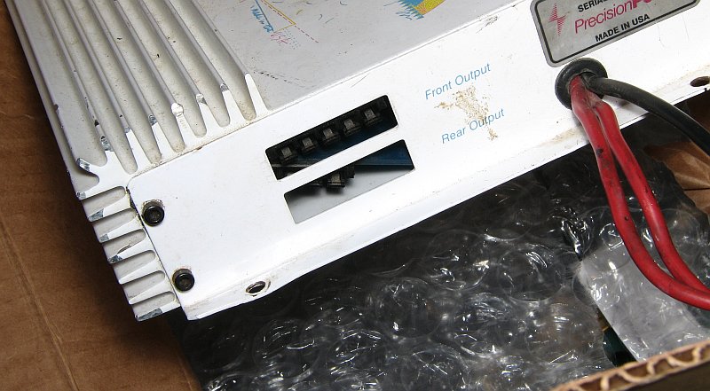

I asked you a while back, lol! I ordered a plug but have not installed it. I ordered a similar type to mount to the board and replace the old. At the time I measured and that was close as I could find. The issue is the plug is so far inside. Now I have two of the 4ch crutchfields and one sansui that all need them.
My sansui I ran a few times, took the med size spade (harder to find those) and flattened it for a tight fit, slid it right on the tabs inside the plug, but no it is not ideal.

I measured and figured, and bought some plug with some others I'm trying to find for alpines. I never tried it, have to get the pins out and see how it will mount. I looked for a plug the same size about, same spacing for the board so I can solder it in. Problem is it is so deep I don't know if the outside plug will go in the hole and be able to work properly....or I'll have to enlarge the hole or something. If not, then I may was well find a terminal block.I new we had discussed this but I couldn't find the email to find the exact plugs and didn't have time to go back and look them up again. I was told (by the owner of this amp) that someone on ebay has sold them recently and was hoping someone knew who he was (or had a source for the exact plugs). Which plugs did you order that fit but are well inside the amp?

The plug I bought was at digikey, A97527-ND and A97526. I have pins for it though, so I'm not sure how I intended to secure it to the board. Maybe using the old pins soldered into the new and some goop, not sure. I'll have to pull an amp down to see if it even fits in the hole. But this was the closest one I could find out of the trillion plugs you can buy at these places.🙄
None of the flat contacts style plugs were right for it, like the old plug uses. Above plug has typical molex round pins. I'll see if I can pull the sansui apart and look closer, I found that amp, lol.

If you look here http://media.digikey.com/photos/Tyco Photos/480764-9.JPG
You can see the nub on the end that locks the plugs together (at top of photo). The flat plate on ends you have to trim down about as much as that bevel on the corner. In the center is the retaining clip I'll talk about (is on each side). The left end (as in photo) goes into the case on the inside. Maybe the clip will not reach into the board but looks like it might. The right side will sit over the board.
Well I have the plug in it and its not too bad. I see what I did, this plug mounts in the panel not on the board. If you nip the ears down to the point it will fit in the hole (one end first), but then the retaining clips (in the center) don't fit. So I nipped about 2/3 the height of those off very carefully, and it went into the hole (very) tight but one bent over and I had to help it with a screwdriver. But it is in there and looks to clear the board by a hair. It does not want to come back out. Then I'll have to solder wires plug to board and make leads for the male side, which clips on there nicely with the end clips so don't mess those up installing it.
This is still a pain to do, but all I could come up with. One could cut the hole a little taller, or actually just a notch for the clip. Now I need to find some colored wire and remember the wiring diagram. IIRC ampguts shows the wire colors. I was going to use a terminal block, but then I'd have to label it somehow and iirc drill holes. If I get the right color wires I should be good here.
The only thing I can't tell is if the retaining clip in the center is going to hit the board. The original plug is still on the board so I can't put it in. One might be able to just remove the top clip, because the plug would lay on the board and could not push into the case that direction anyway....but not sure it would work. If you did that you might not have to trim the other clip. They mounted on the board so would it hurt? Maybe put a little foam tape under it or something. I'll get the old plug removed soon and see what I have. Thought maybe it was better to keep both clips to make it more solid, and it does not move in the end plate. I'll give it some glue too. I only bought one plug so I can't try another with one clip.

Those are not the type of plug I have the plug has flat contacts and rectangular inserts, not round ones with round pin contacts. The sansui and gray crutchfield ppi amps use this plug as well as....well I am sure someone here knows the precise ppi amp models that used it.
These plugs here: Sansui SM-2400 outside - Amp Guts
And the wire colors: Sansui SM-4000 outside - Amp Guts
I need the external harness but it has the flat terminal pins, not the round ones.
