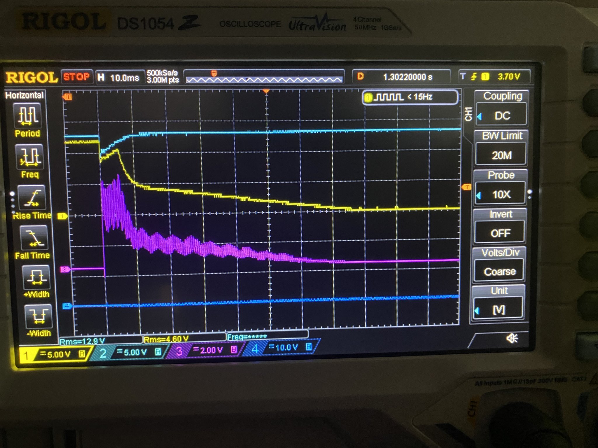

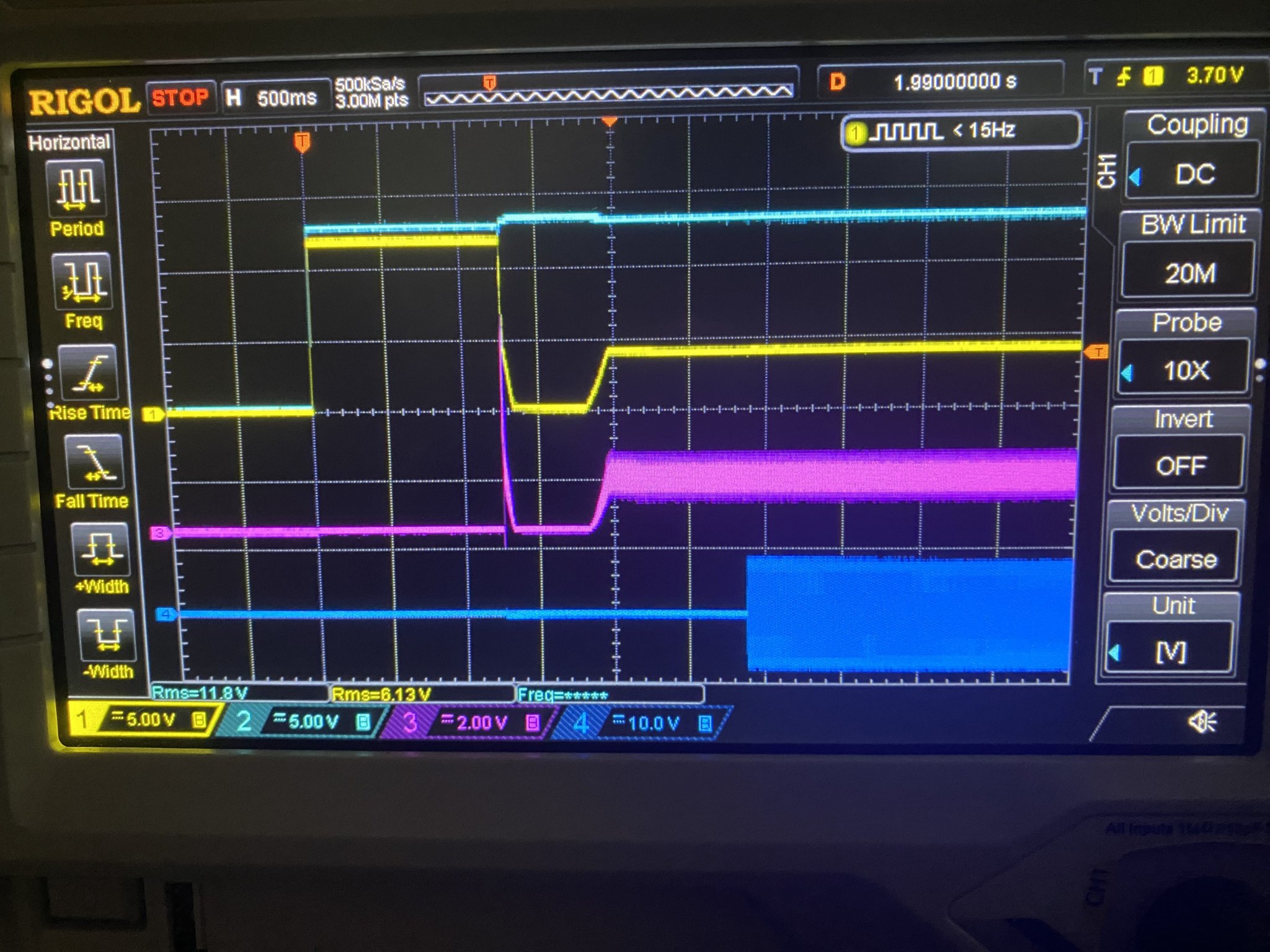

Oh okay understood. Hooked it up to my larger PS. As you can see it takes almost 3sec before audio output. Perhaps I am over exaggerating on the turn on delay for the audio. 2.8seconds isn’t bad.
What if there was a way for pin 13 to start at a much lower voltage than B+, since it does drop to 4v wouldn’t it be best to start it at 4v. I remember when I injected 14v to this pin I was getting 92v rails peak to peak (-/+46v). Perhaps this is what is happening and causing the secondary side to spike. This is just a guess.
