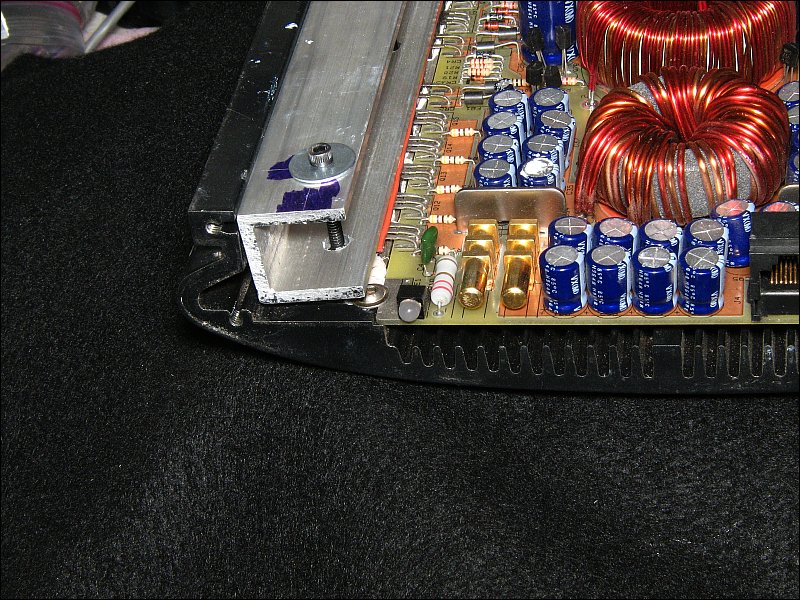

Now I think I done did it. I'm affraid to turn the amp back on now. I tried setting the bias at the same time on left and the right driver boards. I was monitoring the voltage on the right emitters with my dvm, and it want getting very high at all.
Then I heard a small pop, and a slight puff of smoke came out from under my transistor clamps near and around Q22 and Q23 output transistors. Of course I wasnt monitoring the voltage on that side. The output transistors got a little hot, but they dont look damaged outside. DVM set to diode shows everything as being A-OK, but when I apply power I hear the transformer buzzing a bit and I dont hold power to it for very long at all. Kinda scary.
Did I just blow this thing up?

Measure the resistance between the legs of the individual transistors. Do any read near 0 ohms in any combination (1-2, 1-3, 2-3)?
Sometimes, if the tab of a transistor contacts the heatsink, it will do the same thing (pop and a bit of smoke). Measure the resistance from the center leg to the heatsink to see if there is any continuity (at or near 0 ohms).

Looks like Q22 measures 1.2ohms and Q23 measures .7 ohms across pins 1 and 3. I think those TIP35Cs are out. I'm gonna carefully unsolder them and continue this venture. Setting these pots are more difficult than it seems. I measured and the one near the left chan driver board can actually hit 0 ohms. Thats what happened.
The metal bar is painted black, but judging by what I did above it was not the cause.
EDIT: I just took out Q23 and its shorted across 1&3. Q22 still on the PCB seems alright. The parts list grows, but I want to find the other bad parts before I order the lot.

No just paint. I also now realize that the TIP3x transistors are thicker and my bar is not firmly pressing everything to the heatsync. It was tight on the output transistors but not the smaller case ones. I'll fix that.

The simplest and best clamps I've found are like the one in the photo. The channel maintains good pressure along it's length and the silicone rubber ensures that pressure is applied to thinner components.

Yes I de-soldered Q23 from the amp since pins 1&3 are shorted. Q22 still shows good on the scope and I can play tones out of both channels. it doesnt sound any better or worse.
