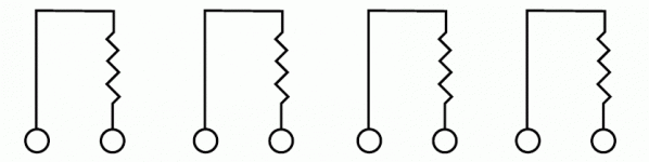

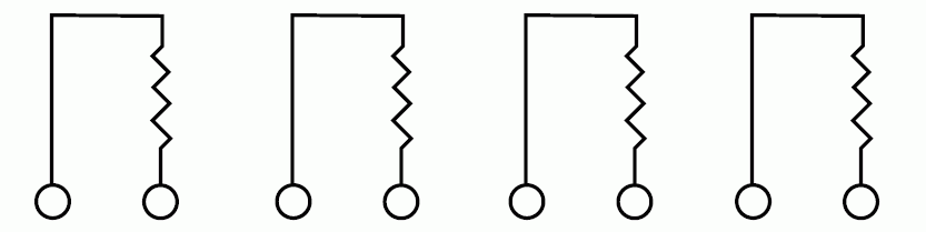

The resistor networks are likely 4 individual, isolated resistors configured as in the attached image. They would be difficult to check in the board. They are 10k ohms each and other, parallel components would likely skew any readings.
