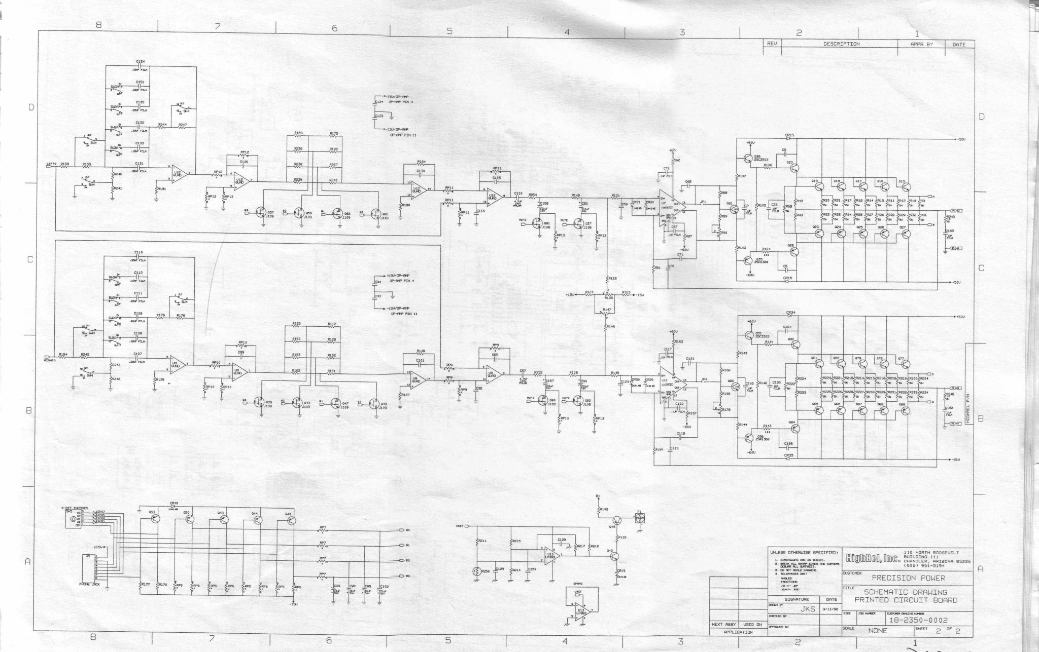

This amp came in with the output driver card solder problem and the power supply pulsing which I've fixed. One of the cards was fixable, but one of the other cards was pretty bad so I replaced it with a parts amp. The amp powers up and idles at about 2A with no DC on speaker terminals.
Unfortunately the amp is stuck in mute.
I removed the two JFets just behind the RCA-Out jacks but that didn't help. The schematic I have shows lots of muting circuits and of course this amp has a bunch (~12) in it as well. There is audio a few of the op-amps but not too far down the path which is telling me mute is happening quite early on I believe. The schematic I have is extremely blurry unfortunately.
Is there a clearer schematic to the one attached, or a better schematic for this amp by chance?
