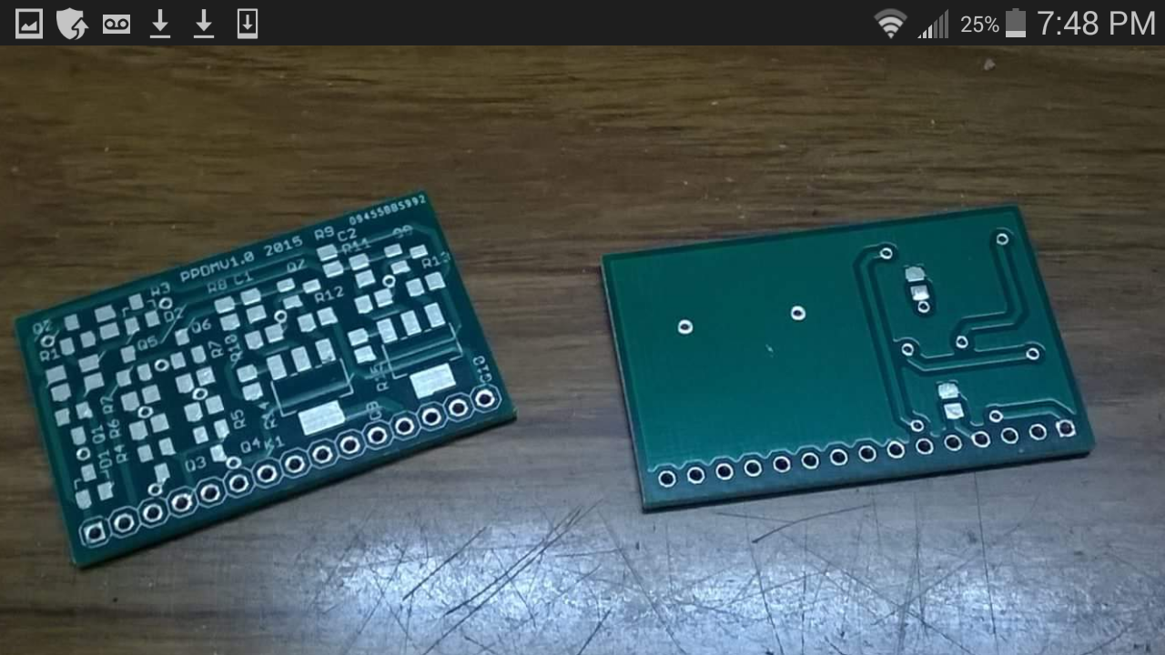

PPI PCX-2200 driver card
I am trying to repair a channel on this amp and found some shorts on the driver card and when I removed it the two suspects fell off the card. Should I try to replace them? What is the small one? Or should I try to build a new one? I found a company that sells replacement cards but they look different, how would I check what components go on the new card?

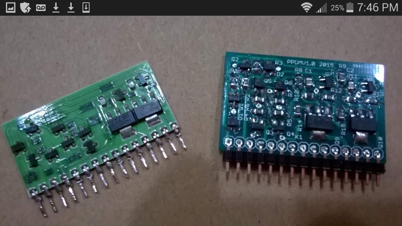

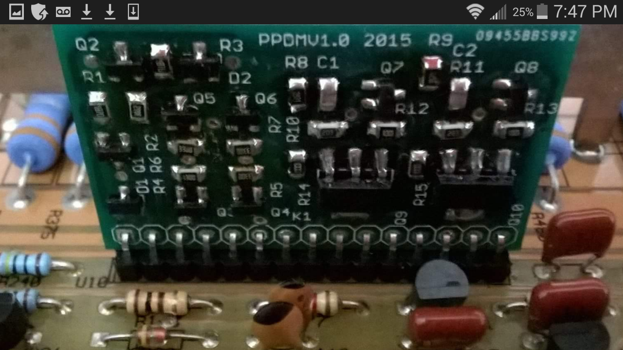

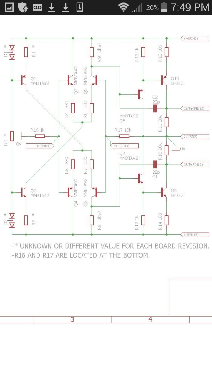

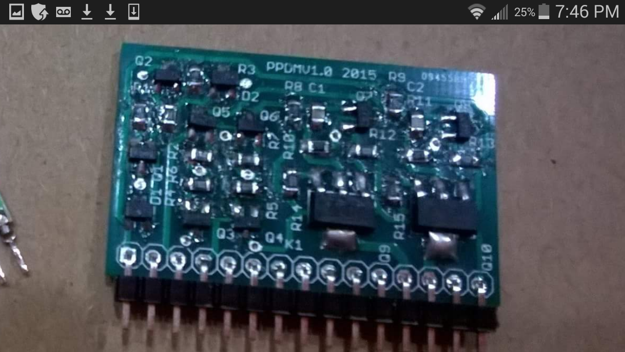

So I was able to get the people selling the card to provide me with a schematic for the card. can anybody make this?? I want to try but am having trouble understanding the schematic and have not tried something like it before. I know a lot of people search for replacements and never seem to find any..
