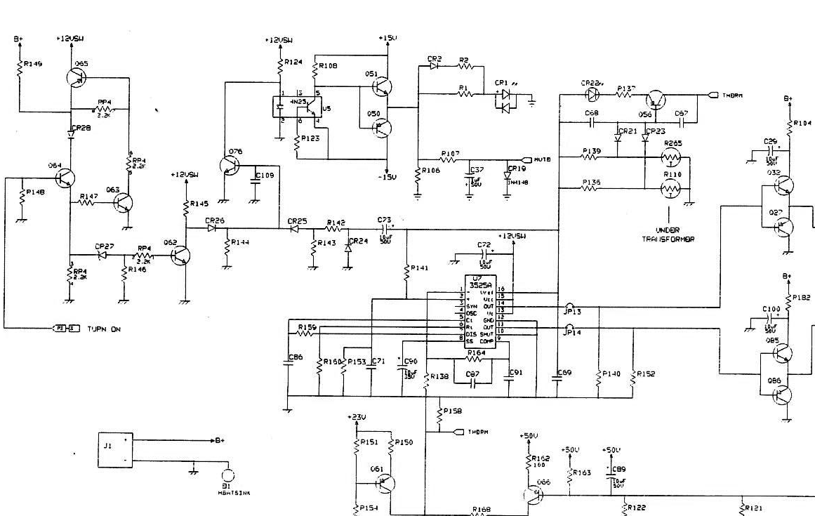

PPI PC4800.2 won’t power on
When power is applied to remote wire, the SG3525 has zero volts on all pins. It will power on and play through all channels when I also connect power directly to pins 13,15 on the SG3525. I have checked (diode test w Fluke DMM) all of the small transitors (A06/A56, A63/A13) that appear to be related to the SG3525 and remote circuits, even replaced a few that measured a little off compared to others, but no obvious failures found. All resistors measure within range, until power is applied. I replaced a few resistors, circuits still tested the same off and on.
I am really stumped with this one. Anyone have any ideas of what I could be missing?
Thank you in advance
Mark
