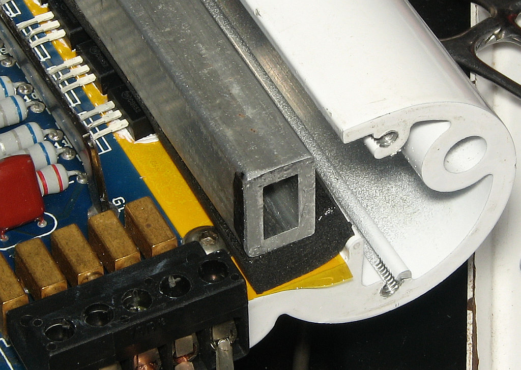

The art amps have a hollow tube running down each side of the sink, you can see them if the ends are removed. If you were hardcore serious about doing it and your friend had the know how, you could just run coolant through the tubes to keep the amp cool. I ran a first series art 600 bridged mono at 4ohms for several years with coolant, a small fuel pump, small radiator and fan, and it never failed. Of course it was only running normal A/B. The first art series seemed to slightly drop power output when ran hard, which is why I decided to run coolant. (ppi also sold the art amp specific coolant system back when the art amps were made if I remember correctly)
The cooling was mainly a gimmick. Look at the attached image. You can see that there is a lot of thin aluminum between the transistors and the tube. Unless you're using chilled water (well below room temperature), the water cooling won't do much more than fan cooling would.
Perry is calling that one right! It was kind of a gimmick back then. And to prove my statement lets look at the amps of equal power back then. They all had FINS on the sink to add surface area to aid heat emission, except for Hifonics and Proton which were a different class amp with their special multi-stage power supplies. If you compare the heatsink surface area of any Art Series amp to any other Class AB amp except Hifonics and Proton and do the simple math of surface area you will see the Art series had less surface area then most amps back then. This is why they offered liquid cooling to this very artfully designed amp. PPI Art series was one of the only smooth bodied Art deco amp designs available, and while sleek and sexy it had less heat sink emission surface area then just about any other amp on the market at that time. So in comes the liquid cooling option for 2 ohm operation and below to extend operation before thermal rollback and shutdown. Oh and the later PC and PCX series had internal fins on the inside of the sink so as to appear smooth on the outside, and the cooling fan blasted cooling air over those fins inside the amp.

I know you like these amps but these heatsinks are close to the worst as far as heatinsking goes. Look at the area under the transistor. They have a deep groove that makes the aluminum thinner. This increases thermal resistance and hinders cooling.
Fins are better in every respect as far as cooling goes. They increase surface area which helps cooling.
For a good heatink, you need low thermal resistance between the semiconductor and the area that will dissipate the heat. On this amp there is a thin area directly behind the semiconductors that limits the heat transfer. There is very little surface area due to the smooth surface.
