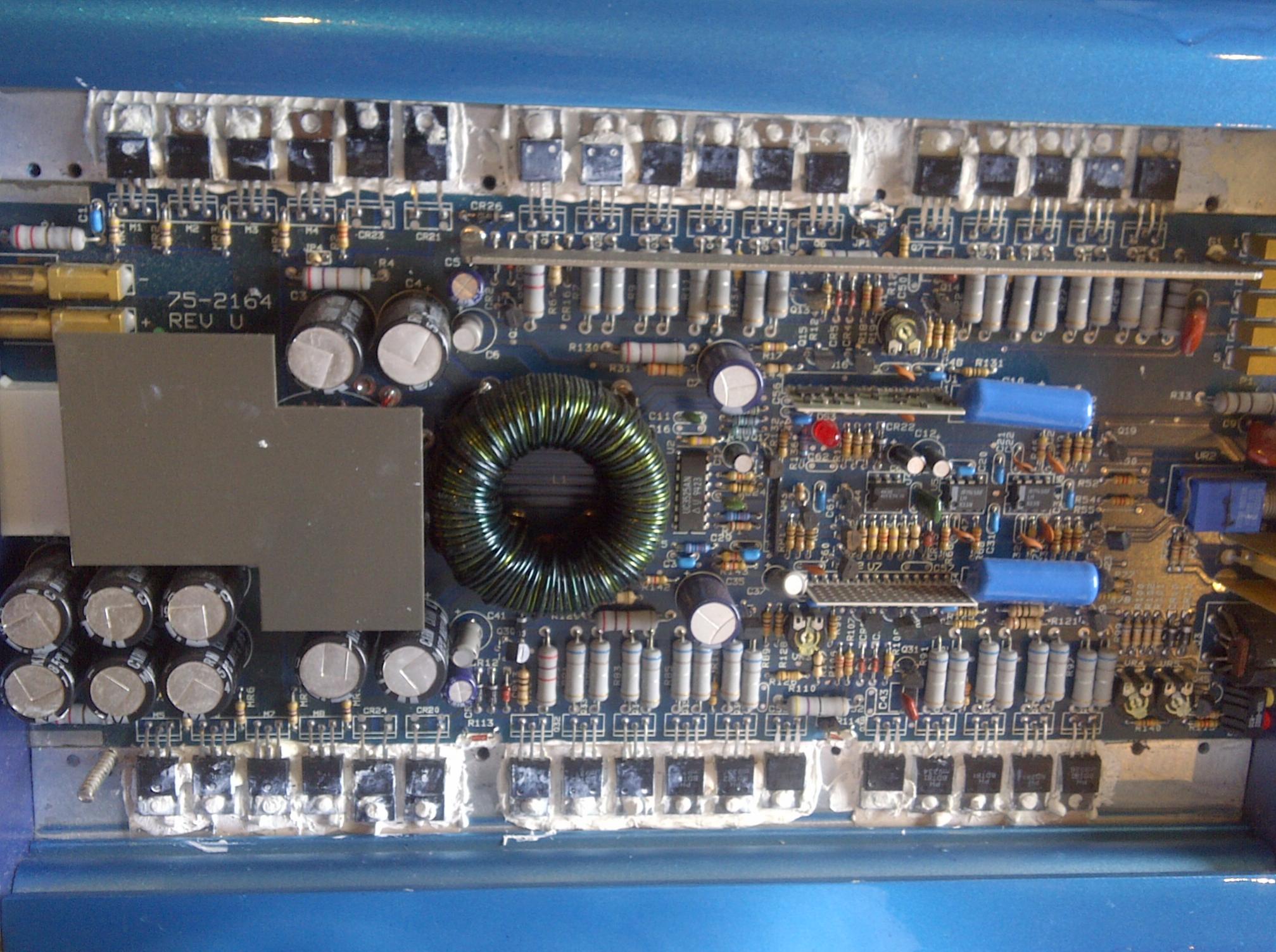

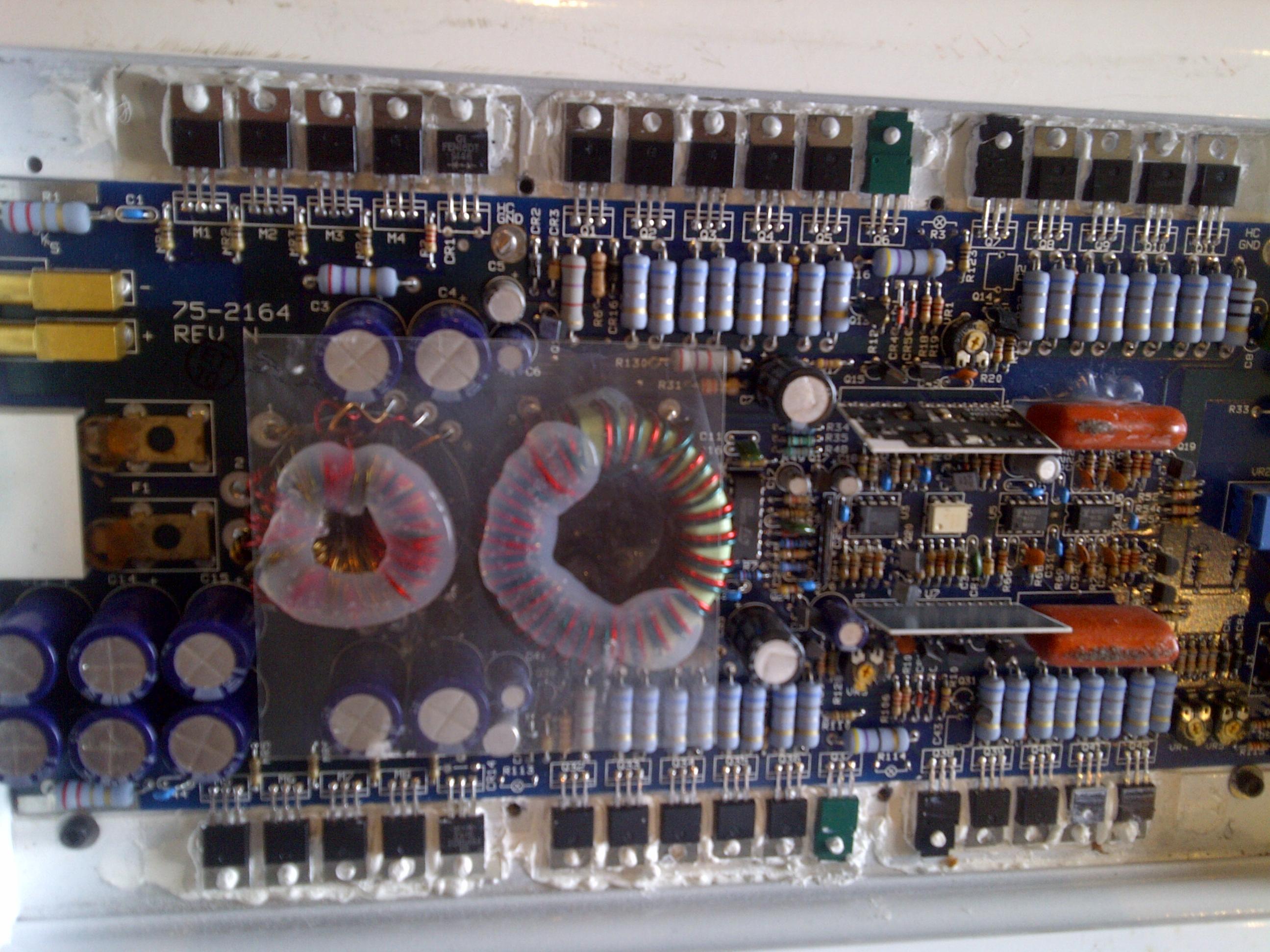

Hi everyone, I have a A600 and a A300 that i bought new. Both are not working now and i am looking to rebuild/fix them. I just bought a working A300 for a good deal and i wanted to use it as a reference to look at in the repair. The A300 that i just bought was repainted and when i opened it up it has the same board number at the A600 with a different rev letter????hummmm So i am sure it is a A600 as it is the same size as my other A600 i got new.
I have been looking around this site and seen lots of info, but i was just wondering if i could get a link to what i should replace in my A600 and A300 to make them as good as new. I would like to replace all mosfets, maybe caps if need be and another parts that would be beneficial.
The board number is 75-2164 REV N (one i got new in 90)
Amp i just got 75-2164 REV U (said to be a A300)??? does anyone know for sure as it is the same size chassis as A600 that i bought.
A300 i bought new is 75-2084 REV F

Some amps like the older orion amps and some of the older PG amps have significant problems with capacitors (leakage of electrolyte causing damage to the board and other problems). I've repaired quite a few of these and don't remember seeing any leaky capacitors.
The power supply FETs probably don't need to be replaced (except for those in the power supply that failed). The output stage uses BJTs, not FETs. They may have failed in the amp with the blown supply.
Unless you have good equipment (soldering/desoldering) and can replace parts without damaging the board (some people do a lot of damage when replacing parts), I'd suggest leaving the working amps as they are.

I'd suggest that you use a different FET like the IRFZ44 (any version will work). You'll also need to replace the gate resistors if they're greater than 100 ohms. Anything 100 ohms or less should be OK. Values between 68 and 100 ohms are good choices.
When you get the amps working, you need to compare the rail voltage in each amp. The 300 may have a different transformer or different regulation than the 600. They may also be identical.

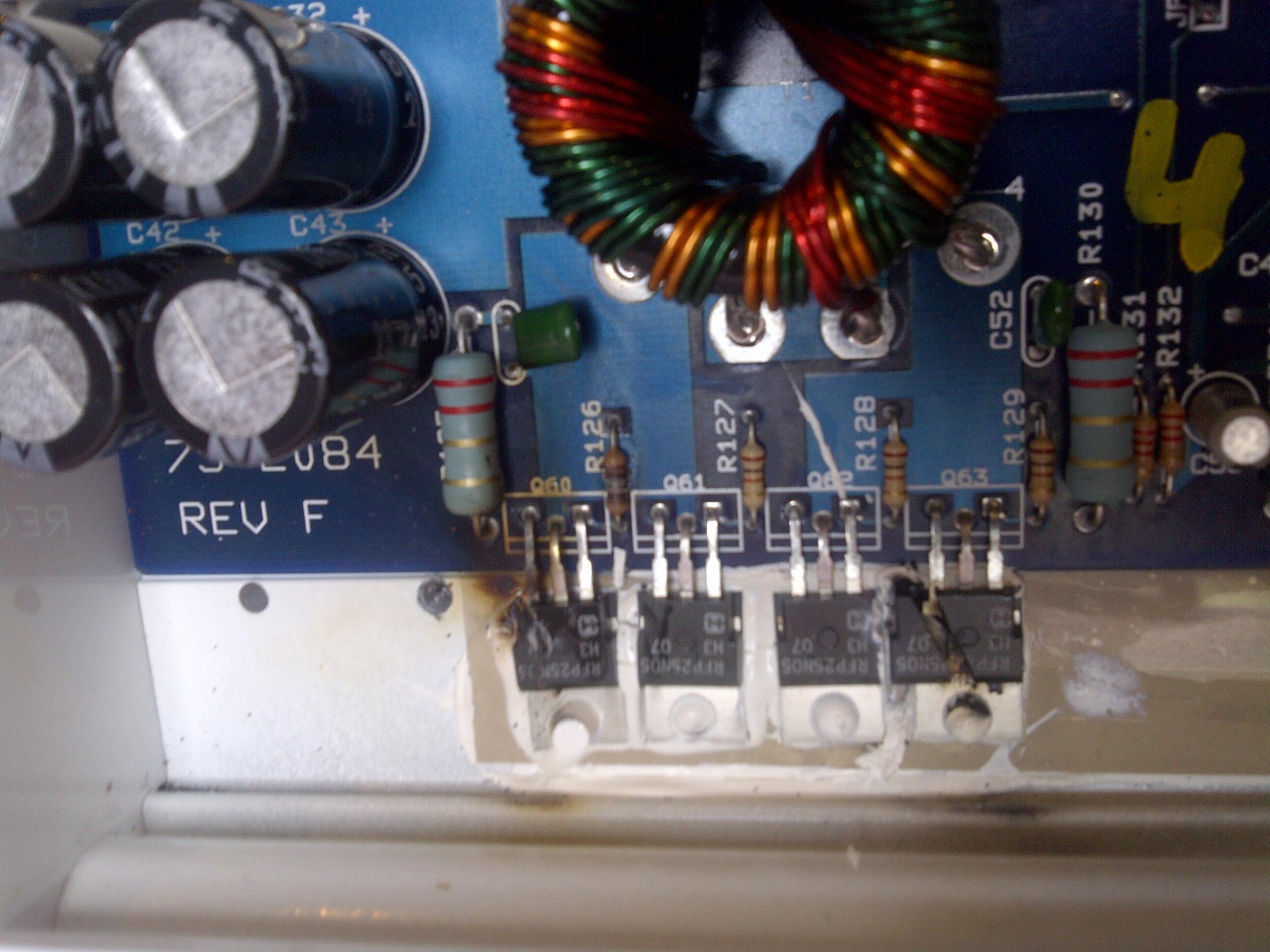

Sorry Perry can you cancel that last question as i had a brain cramp..lol I just dug into the A300. Q60 to 63 all need replacing plus the gate resistors. Are there known reasons for Q60and Q63 to split in two.I also found Q1,2,3,7,8,9 to have BDT82. Some of the BDT82 have different production dates by four weeks, would it be good to replace them with a matching set.
FETs used in the power supply often split open or burn. I'm guessing that they crack because of expansion of internal components when they burn (due to excessive current) but there may be another reason.
