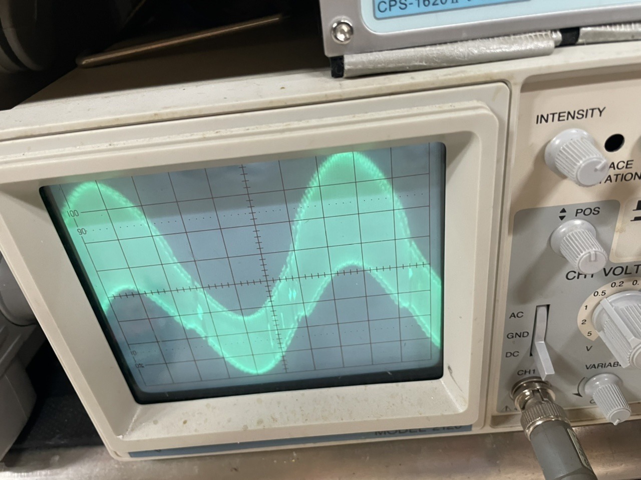

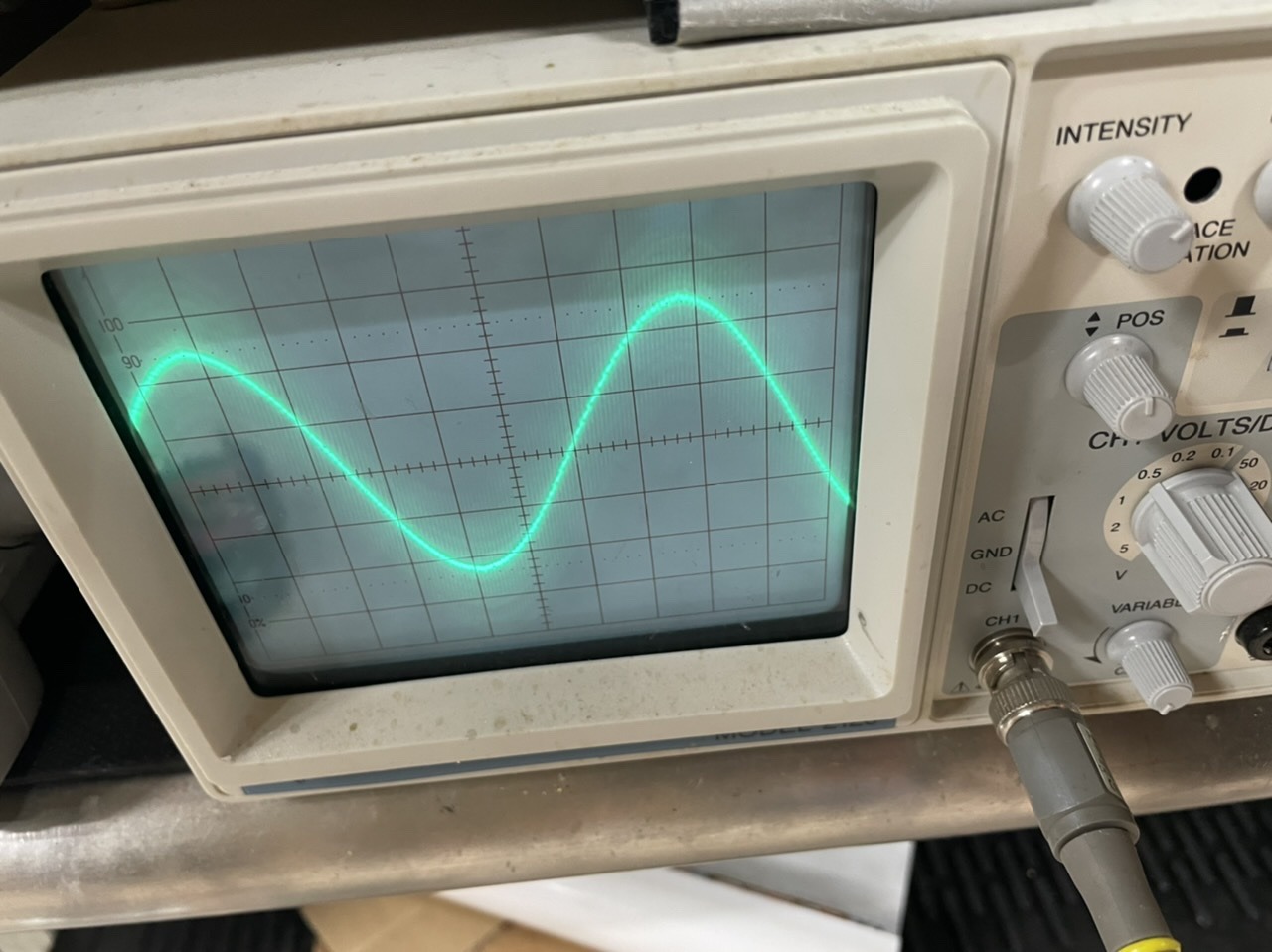

Signal on pins 3 & 4 of the driver board looks clean and identical while the shunt is in. WIth the shunt removed, pin 3 (Input) and back through several ~1k resistors looks very dirty. On the scope looks like some sort of massive ripple
Here are images on R55 with shunt IN (clean) and OUT (dirty)
