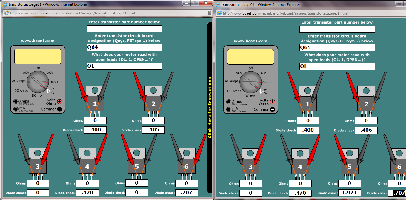

Q7 thru Q18 look to be shorted but because they are in parallel they will all read the same pretty much. You likely only have one or two bad transistors but since these are connected together in a array I replace them all with a new set of devices. < this is my method but its entirely up to you. for what they cost all new is cheap insurance the job was done 100% correctly IMHO >
You can lift the center leg of each device and remeasure and only the shorted ones will show up in most cases. I use a dental tool to lift the center leg out of the board after heating with a iron. Then read from the center leg to the outer legs will show the single devices that are shorted. Once you remove those shorted devices and reinstall the center legs of the rest. You can clamp the base back onto the amp or install your set of home made clamps and apply power to the amp to see if you have clear all the short issues. if you choose not to replace them all....

Ok thanks I forgot ur name so I have to take out the board out of the case and just heat up the center leg and pull it out of the board?
I leave the board in place and use a dental tool underneath the center leg of the transistors and while applying heat to the solder joint I gently lift that center leg up out of the board connection point. With this one center leg out of circuit you measure from that center leg to the other two legs only. This will show you which devices are really shorted, and you can pull one of the other legs of any shorted device out of the board and the short will be cleared. This will leave the bad device connected by one leg < out of circuit basically > and waiting for new parts to arrive to replace it with...hope some of this helps...😉

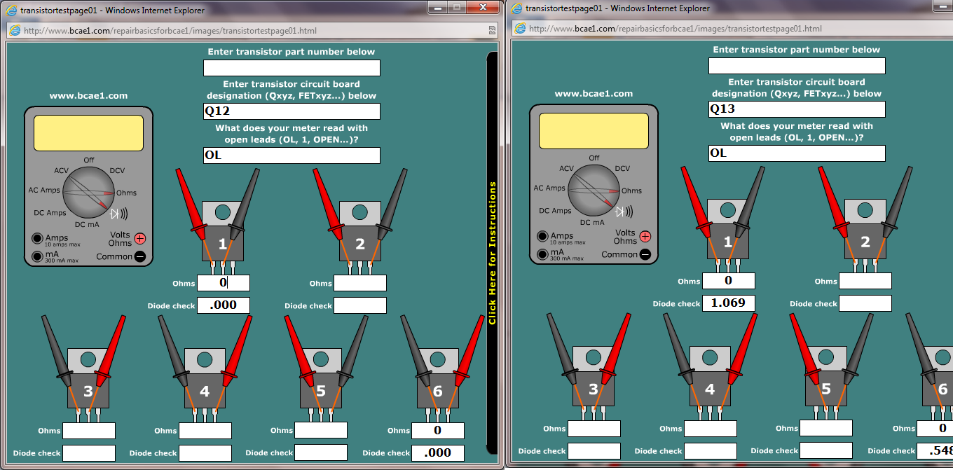

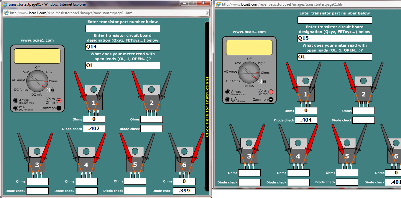

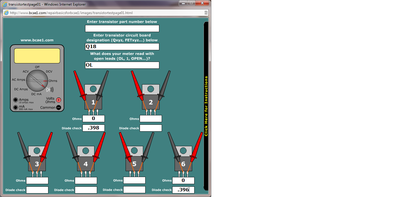

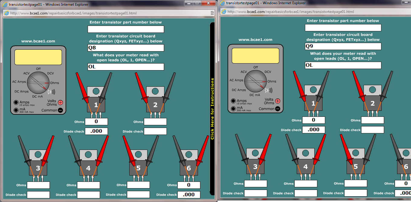

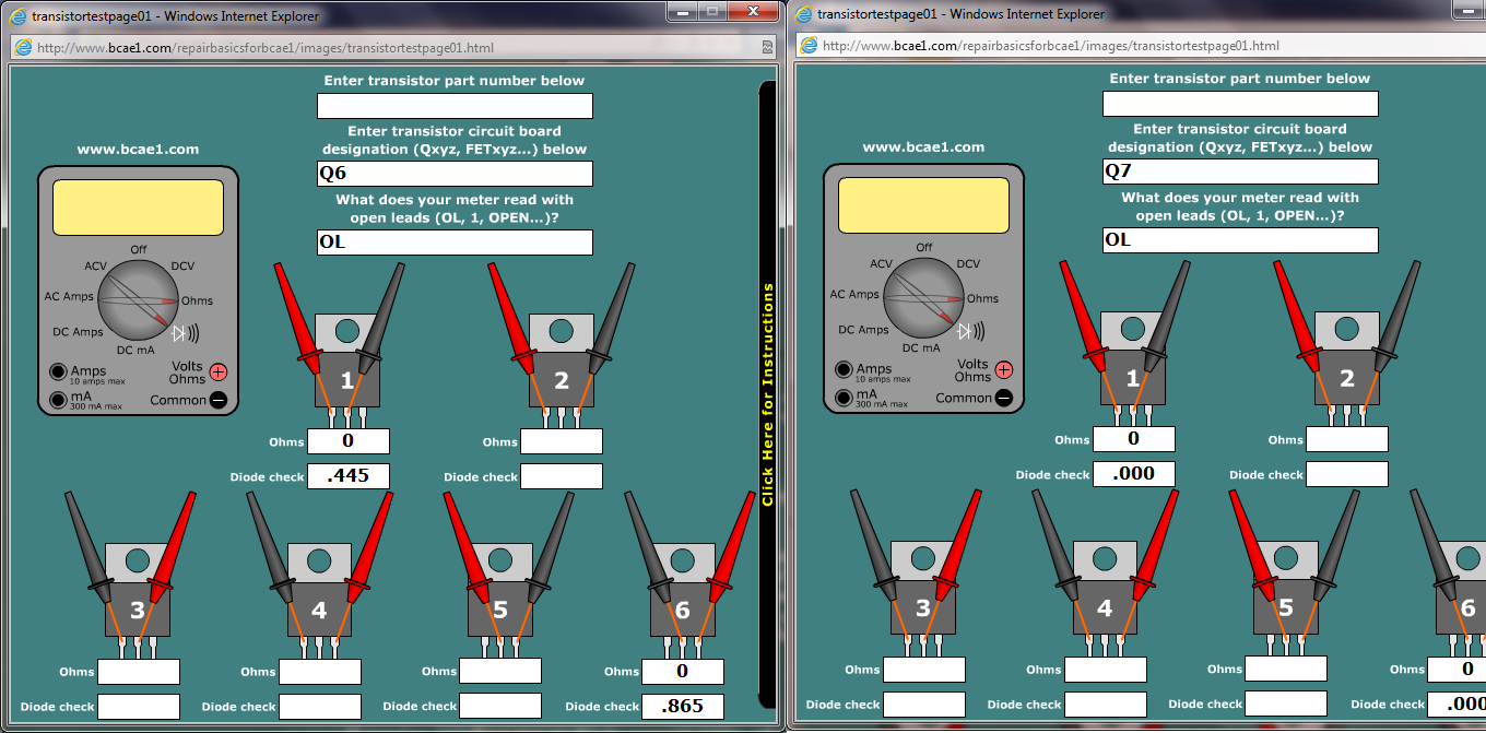

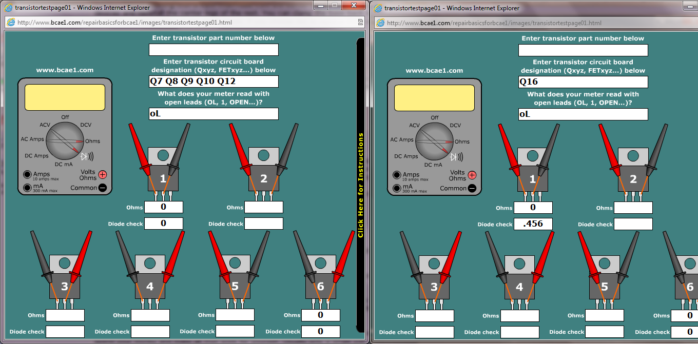

ok Q6 to Q18 tested with center legs out
ok i tested from Q6 to Q18 with center legs out of the board. here are the results thank you and i got me a new solder iron been trying it out on my other board trying to get use to how to quickly remove those transister are a pain in the butt lol but o well i'll get better haha
Q6 to Q18 pixs
here are the pixs forgot to post

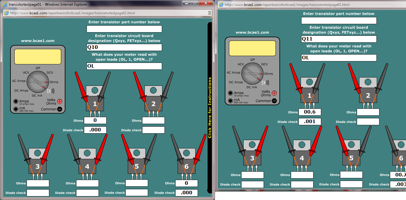

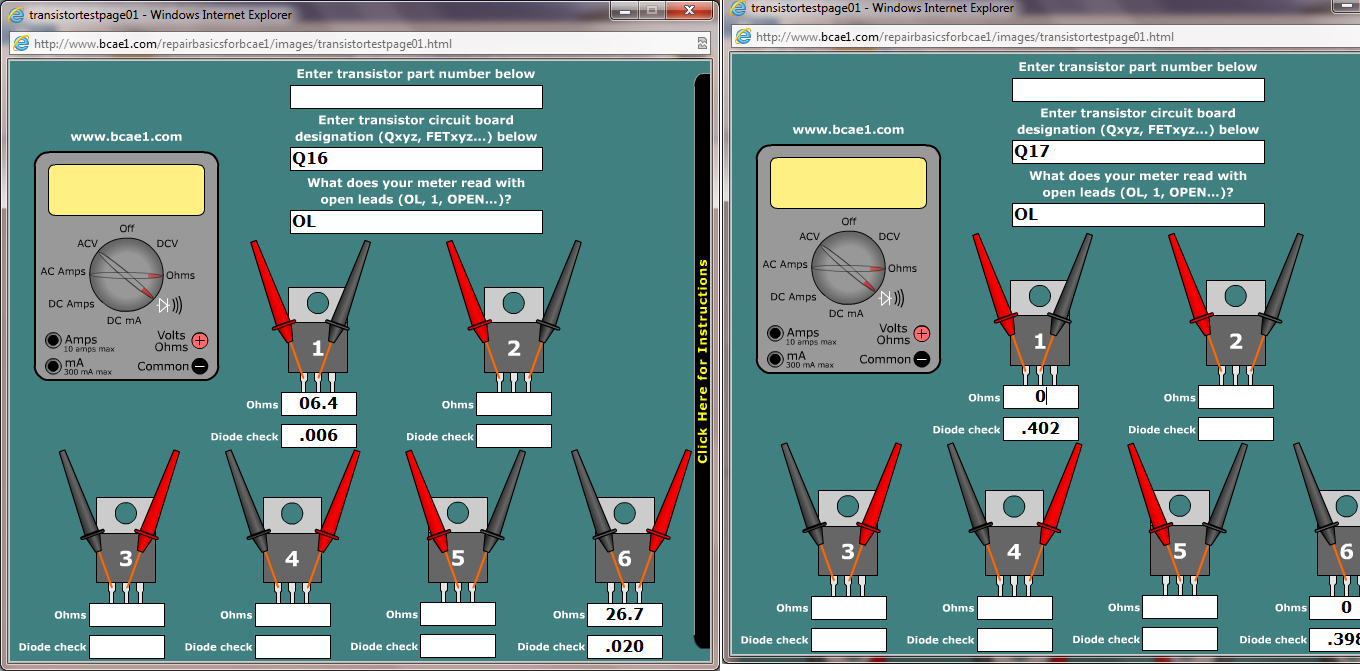

Well if your numbers are correct then Q7, Q8, Q9, Q12, Q16 are shorted. The others may be damaged by this failure mode but I would say pull the third legs of each transistor numbered above. And continue checking the rest ...
ok and i think q10 is shorted too right? and should i pull out the transister on the ones that are shorted sence i have to replace them anyways? but the third leg is the ones that are towards the rca right? and do u want me to still check transister Q7 Q7 Q8 Q9 Q10 Q12 Q16 after i pull the third legs out? or checking the other side of the amp transister?
thank you again
thank you again
Q10 yes its also bad . Just pull the third leg < towards the RCAs > out of circuit on all the bad ones, and leave one leg attached. The reason for this is when you get new parts there won't be any confusion as to what went where. please check the other side also...
Yes its bad. Any reading below what a normal diode junction would read is bad. So anything below 340 ohms or so is bad. Usually they will read in the 20 ohms or less all the way down to 0.00 ohms. it sort of depends on the quality of you meter somewhat as to what numbers you will get. But number of 340 up to 760 are a normal junction reading.
Your amp seems to have blown all the 2N6490 outputs. Q12 is the driver for those outputs please check it carefully like you did the others it likely is also damaged with all of those outputs being bad. I have a A600 open on bench at this moment so I am comparing your info directly to my unit here😉

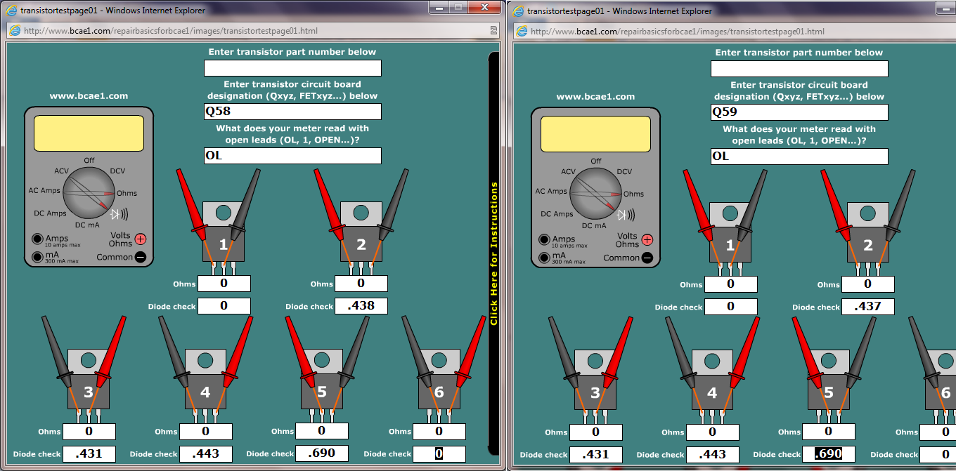

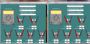

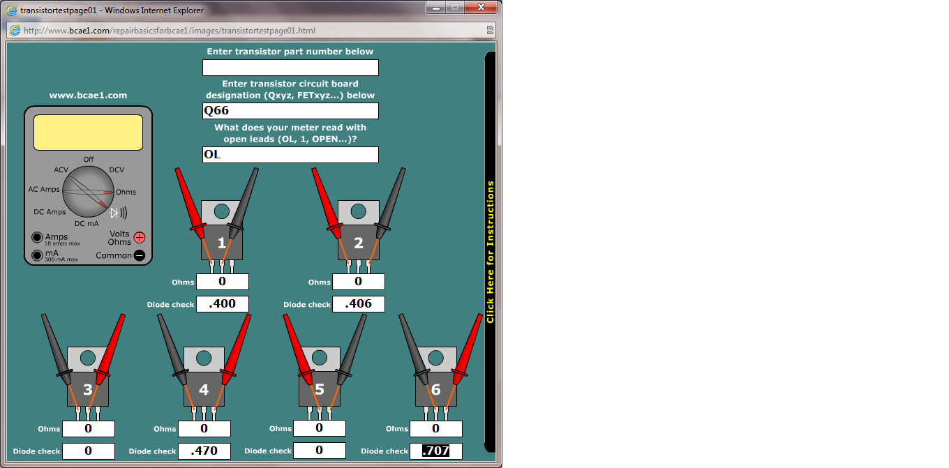

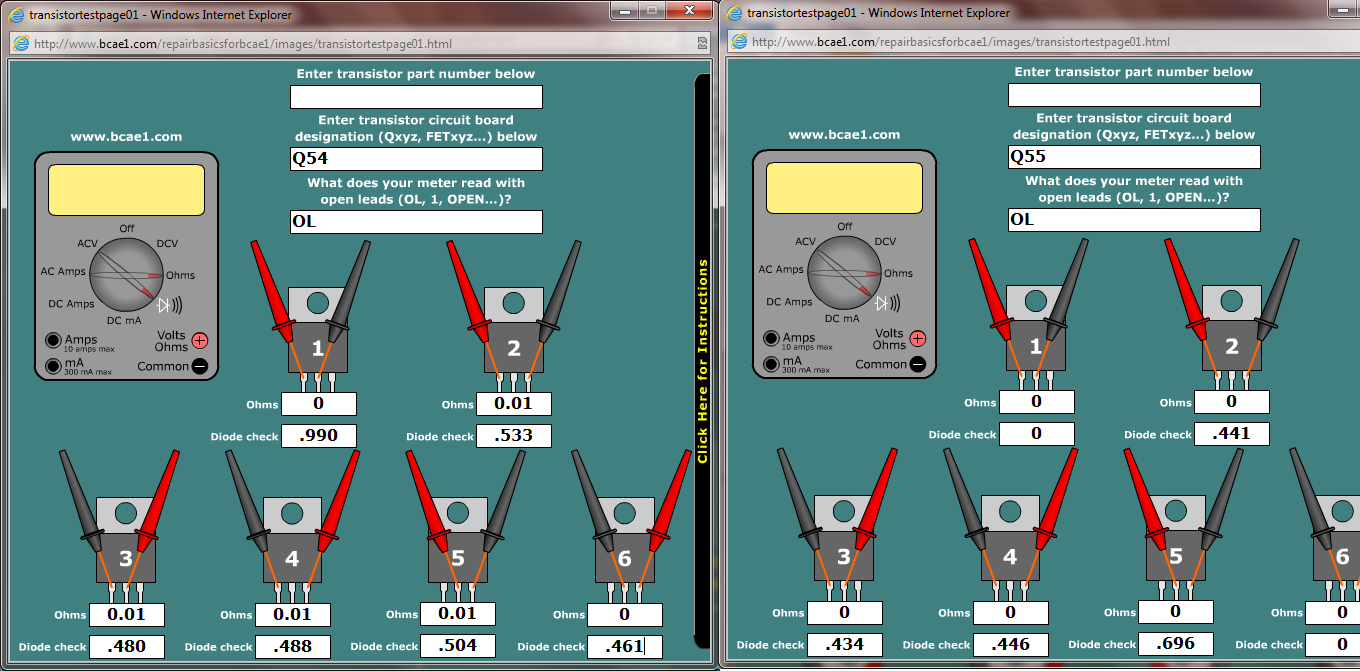

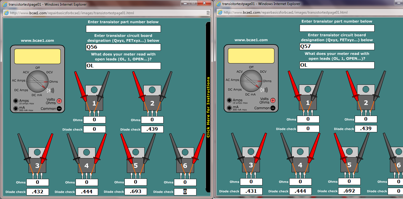

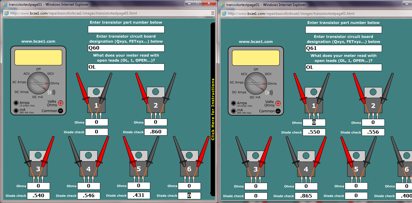

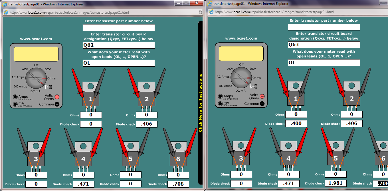

here are the reading for the otherside of the amp of transister
hey everyone here are the rest of the reading of the other side of the amp transister. The transister are still in on the otherside, so here are the results🙂
Comparing your readings to my known good amp on my bench all of these transistors are reading OK.
So I would concentrate on the other channel as your real problem for now.
Also Q54 & Q6 are not output transistors, They are lower rail pass elements < +&- 15 volt regulators >. These have large voltage drop across them when the amp is powered on so they will get hot and blow out if they are not sinked properly. This is why I work on these in the sink and why this amp must be properly clamped back into the sink before applying power to the amp for testing purposes. Make some U channel clamps like Perry recommends, please...😉
