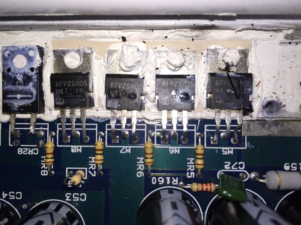

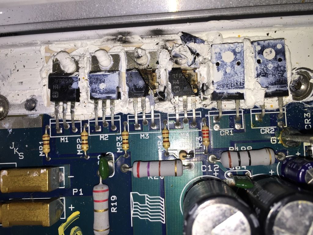

Overview of the board with visual damage noted. The ground bar is not secure at one end and three of either power supply FETs have burned. The main power fuse is not present. Capacitors show no obvious damage, nor do resistors or any other components. Given the obvious power supply damage and missing fuse, presumably blown, I have elected not to power the system up until power supply components have been tested and failed components replaced.

You need to replace all 8 of the power supply FETs.
Confirm that all of the gate resistors are within tolerance.
If there are driver transistors between the driver IC and the FETs, check them as well.
It could have shorted output transistors so you need to check those.
Be aware that you cannot operate the amp at anything more than idle without the bottom cover tightened down. Even at idle, you have to monitor the temperature of the transistors.
