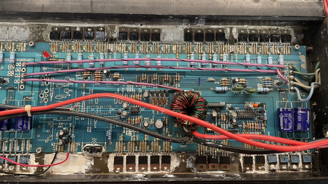

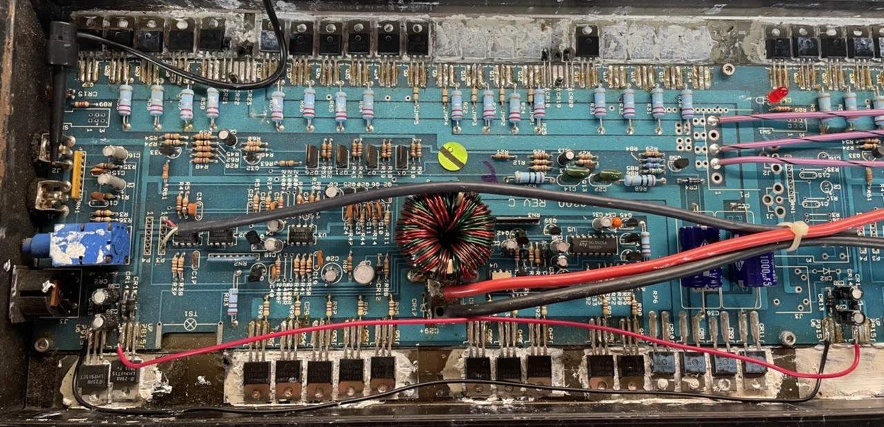

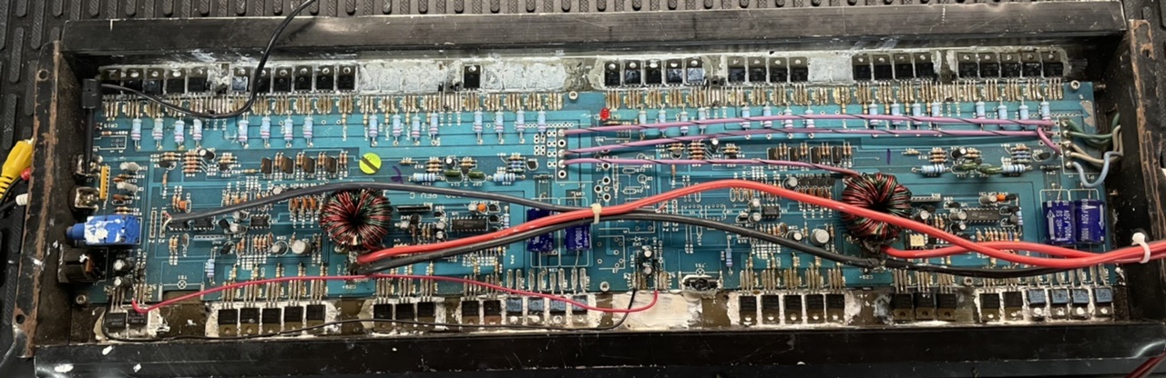

This single board is 2 amps in one. Two separate PSs, SG3525s, and outputs. Its dual mono amp. Looks like the board<s> are actually 2 channel boards that are bridged internally and then sent out as 2 channel. Seems like a 4-channel amp internally bridged. There are a bunch of faults such as all the missing and mis-matched outputs; I'll be able to easily work through, but I have a question pertaining to regulators.
When I first powered on this amp, only the LEFT side of the board produced output. The RIGHT side of the board had rail voltage but no regulated voltage hence no audio. Thats when I saw someone had removed the 15v regulators from the RIGHT side of the board. The Left & working side is using LM340T15 and LM7915CT - which I don't have any. I have LM337 and LM317 but those are not fixed +-15v.
So to be sure the non-working channel would possibly work; I temporarilly tied that side to the working regulators - and it worked. Both channels now produce audio. (Thin RED and BLACK wire)
Can I leave it like this? Amp Center Taps are tied together anyhow via the purple wire from the right Toroid to the Left non-bridging terminals. If so then I have all the parts to restore this amp fully, but I'll have to keep the regulated voltage tied, or just go ahead and order 15v regs.

1 new LM7915CT is only 30cents.. that same for the LM340T15, you could also take LM7815CT..
The way you propose the AMP will not survive..
Fix that the right way in the way of Buying these Regulators, and soldering them into place..
Who ever build this amp had a reason to use the way it is designed. I would follow this reason.
Not those things at all. Its partially because I've not seen many amps like this with 2 amps inside. As far as I can tell there is only one 8-pin IC that needs the +-15v on the right side. At the time of my temporary modification it seemed kind of a 'waste' to have two sets of regulators if only for that one IC. The left board is handling all pre-amp activities and the right board has none.
I'll order some new regulators for this amp. Thank you
