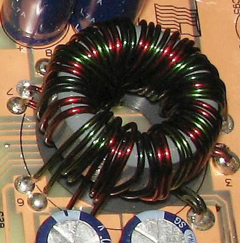

no i conn the right+ to left - together hooked it up to the red multi conn. the black to the rca it read 10.5 i just testedthe output side that run to the speaker conn. was zero (onthe left of the picture WHAT IS THE B+ TERMINAL
The B+ terminal is the terminal you connect to the positive terminal of the battery. Measure the resistance between the B+ terminal and the shield.
There's no reason to connect the L- and R+ together. If you measure the resistance between them, you'll find that they are directly connected (internally).

You need to measure the resistance between the B+ and shield to confirm that the transformer is shorted. If it's not shorted, you may not need the resistor.
As a side note, it would be better to measure the resistance between B+ and the non-bridging speaker terminals but there seemed to be a bit of confusion there so I suggested using the shield.
If that's the case, the transformer isn't shorted unless the short is intermittant.
It's strange that you didn't get any reading. I would have expected a changing reading as the filter capacitors charged.
Measure the resistance between the chassis ground terminal and the L-/R+ terminals. You should read ~270 ohms.
