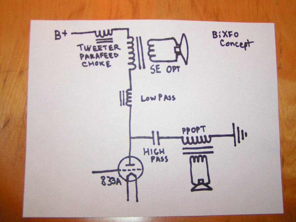

Bitransformer concept for large SE tube amplifiers.
Tweeker,
The biggest problem with that circuit that I see immediatly is that the LPF choke and the other also in series with the bass OP xfmer will soak up some of the available bass signal, just as voltage and power divides among strings of resistors in series. You are not going to get very good efficiency in LF energy transfer to the LF speaker.
Placing an iron choke in series with an output xfmer that is too small (not enough L) to operate at the lowest audio frequencies is a trick that can be employed to get 20 Hz out of a smallish xfemer that otherwise saturates, but it is at the expense of output power and circuit efficiency. No free lunch. That seems to be the law.
Well, the LP choke could be removed, and if need be placed on the secondary side.
A 2 course lunch of biamped GM70s might be more sensible, but sometimes I like to have a large dessert instead of a sensible meal.
Tweeker said:Well, the LP choke could be removed, and if need be placed on the secondary side.
I think that would work.
A 2 course lunch of biamped GM70s might be more sensible, but sometimes I like to have a large dessert instead of a sensible meal. [/B]
I think your idea has merit in that it provides an opportunity to use a PP OPT to obtain two band split outputs from a SE output stage as an alternate to building an entire extra output stage with a second tube and it saves having to buy a more expensive (than P-P) second SE output xfmer..
This would be a simple modification of existing SE amps that have enough muscle and room for the extra xfmer and coupling cap needed.
Driver level balancing will needed to be accomplished by passive pads in front of the loudspeaker drivers.
