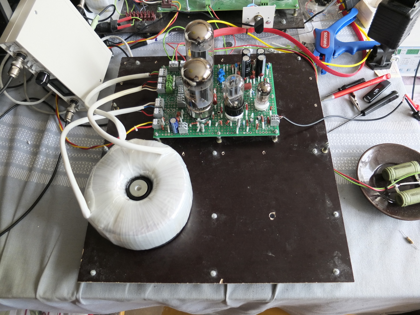

That's an actual tube OPT, right? I've been talking about using power transformers as OPTs so in my experience they can tolerate more imbalance. Still, that doesn't look bad given the frequency and almost 20% misbalance. What's the DCR of primary?

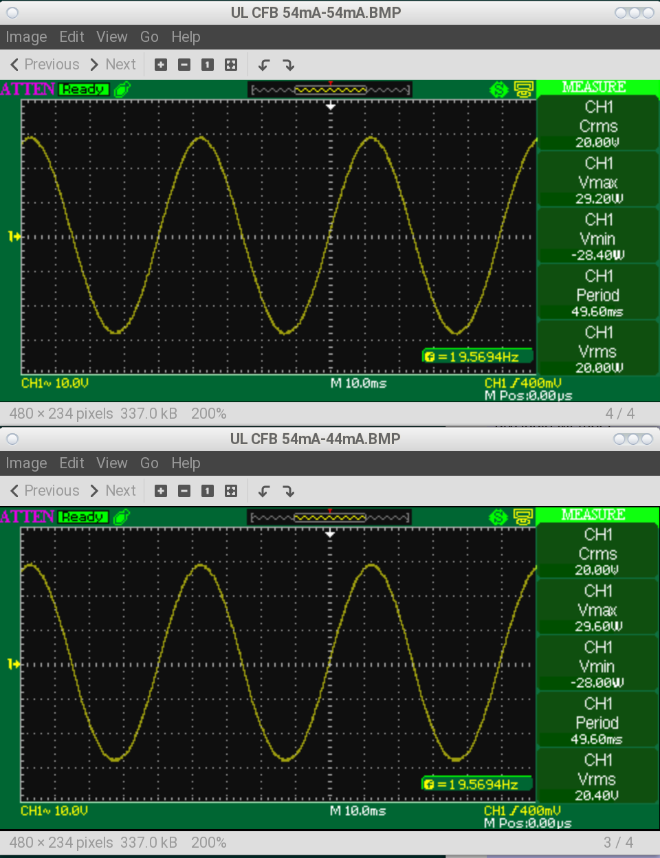

Here is an oscillogram of 2 setups with the toroidal output transformer, fully balanced 55mA idle current (top), and 54mA / 44mA imbalance (bottom), 20V RMS on 8 Ohm. Differences can be found with a spectrum analyzer.
Can you help me understand what I'm looking at? I don't see any difference at all - same swing peak to peak, 2% difference in RMS, waveforms seem visually identical. Am I missing something? Does this show up on the spectrum analyzer as something more dramatic?
It is written clearly in my post - an oscillogram of 2 setups with the PP toroidal output transformer, fully balanced 55mA idle current (top), and 54mA / 44mA imbalance (bottom), 20V RMS on 8 Ohm.
It means output toroids CAN tolerate a typical imbalance if are designed to do so with no core saturation.
I had spectrum analyzer graphs when tested but it lost, trashed some pieces of my digital archive a long time ago.
Yes, real tube output transformer. DCR was about 100 - 120 Ohm, I had several different prototypes.
BTW, I wouldn't suggest using generic power toroids for audio output, this is not a good idea from any angle.
Sorry, I couldn't tell whether you were showing that it was a bad idea, or that it wasn't a big deal! Appreciate the clarification.

50 Watts into 8 Ohms at 20Hz.
A microphone to the scope, and most woofers at 50 Watts and 20Hz will not look that good.

Technically possible to make output toroid good from all aspects, incl. immunity to moderate DC imbalance (Achilles' heel of that kind), yet the same can be achieved with classic C-Core, less time consuming + lower cost.
So, if we drop the fetish factor out of the picture, output toroid is not a big deal.
