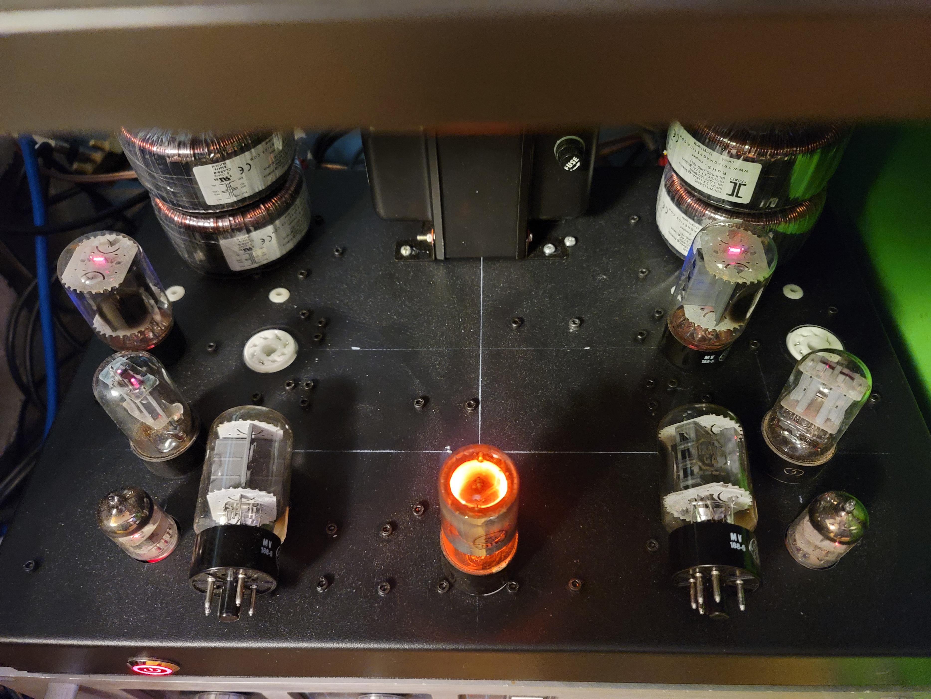

No damage, possible distortion of LF. It really depends on the coil. I've had a 120mA (missing tube) mismatch on mine with no noticeable distortion, but I use power transformers interleaved to have my OPTs. They are designed for much more primary current than a tube OPT.

That's why my pair of 250VA coils interleaved don't mind 120mA misbalance when the SE power is probably about 1W 😀 Normal OPTs aren't 250VA @25Hz, and don't have a primary DCR of 12R, either.

As expected, I get about 1W (instead of 30W+) output with an 60mA mismatch the f*cking tube is out of the socket FFS!), but it's not la fin du monde. It makes me wonder if the output would be better but still SE if instead of removing the tube from it's socket, I removed it's drive and grounded it's grid instead. No more mismatch but still single ended. 🙂 Wire it to a switch and call it a feature!

Still. Short one grid to ground and single ended it is. Just not as elegant. I Short pin 1 and 3 of an XLR to the same end.
