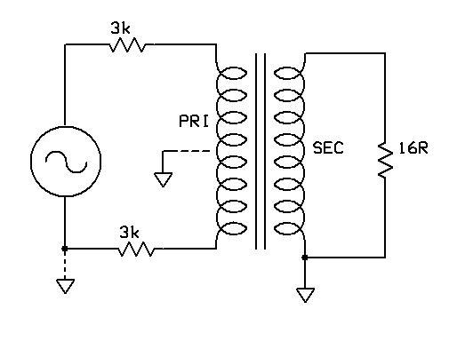

Yes, I connected transformer primary end to end to the generator. In class A for example both tubes are conducting all the time, so what exactly is wrong with this kind of connection?

Just to be clear, this is the setup I used for the measurements shown before.

For a PP transformer the CT is at ground potential and moving that to another part of the coil can have interesting effects. Since you have the transformer try it and see what happens.
Also are you connecting the CT to the ground side of the secondary? If so, there is a reasonable chance that leaving the entire thing floating will eliminate the dip.
dave
Nothing, I belive you have it right. Since the Class A PP both tubes are conducting 360 deg. your sig. gen has to be across both coils with the series resistance that equals your primary Z. And since the CT is B+ and not ground you should float it. However, you still have not determined your tranny's primary Z. How can you simulate the tube to go with your tranny if you don't know the input impedance first? You must calculate that with a different test.
the series resistance should be that of the intended source, not of the transformer impedance. If the intended source is PP class A 2A3's then series resistance should be added to make the end to end source Z around 1600 ohms.
B+ is connected to ground through the last decoupling cap (or regulator) so therefore it is at AC ground and since we are talking about AC behavior the CT should be referenced to ground if you are interested in accurate results. Furthermore, the signal generator must be floating otherwise one end of the coil will have ground reference which will also skew the results.

You should use a tube and plate voltage combo that creates the same Z that matches the transformer. He's testing for FR of the tranny. You gonna do an FR test for every plate z a person could use?
I've got to agree based on my own measurements that using a generator with approximately the same resistance as the effective anode resistance of the output stage is pretty important if you are actually trying to predict the in-circuit performance of the transformer.
On the other hand, if you have the measurement for one source resistance, c.f. the 650 ohms given on the datasheet for the LL1620, you can pretty much guess the effects of your own circuit impedance well enough to decide whether or not to select the transformer...
As Yves says, when using pentodes with feedback you have a low effective plate resistance also, for the moment ignoring whether the OPT is also in the loop.
Using the proper load resistance on the secondary is also very important.
Lastly, which primary tap (and secondary tap for an interstage) is at AC ground is important, much moreso for some transformers depending on the winding design.

I had the need to bench test a certain pair of rusty PP OPTs that arrived in the post yesterday (Thanks George!) to figure out which output tap was which. I had guessed already but always check, plus I wanted to do a little experiment.
The first thing I did was the naive test hooking up the generator with it's 50 ohm output impedance across the whole primary and the scope probe across the unloaded secondary. The result looked almost identical to the first post in this thread at the high end. A dip at 40 KHz followed by a mild peak, then rolloff.
Then I reversed the primary. The result was a couple of db peak at 40 KHz followed by a rapid rolloff.
Next I added an 8 ohm load to the 8 ohm output tap. The result with the first polarity was a smaller dip at 40KHz, -1db at 18KHz, the other polarity was a smooth rolloff starting about -1db at 20 KHz.
OK, what about the actual use conditions, which are for push-pull class AB with local feedback?
I connected the center tap of the transformer to the generator ground and one plate terminal to the generator through a 220 ohm resistor to simulate about 270 ohms effective Rp. the other plate terminal was left floating (as in class AB with one side driving, one side cut off). The response this way was -1db at 16 KHz, -3db at 25 KHz. Driving the other plate terminal was a little worse, -1db at 12 KHz and -3db at 18KHz.
I'm not sure this exactly duplicates the class AB operation; there is continuous drive from one side vs. discontinuous drive, but at least the AC voltage reference is corerct, and it does make a huge difference.
Metaconclusion:
A given transformer doesn't have a frequency response, any more than a particular tube has a sound ;-)
A transformer has inductance, distributed capacitance, and I suppose other attributes which result in a particular frequency response when used in a circuit with certain impedance and AC drive voltage characteristics.
Transformer testing should approximate as much as is practical the impedance and AC drive conditions of the circuit the transformer is to be used in.
Michael

Hey Michael,
Agreed on your results and I routinely see similar behaviors which is why most transformer measurements are meaningless unless they are done with the needed source and grounding requirements.
This is accurate for the "class B" peaks of the AB cycle. the "Class A" or low level response may be quite different than the simple averaging of the halves of the Class B operation since the impedance values are completely different.
Can you float your generator to try a balanced situation? Also were you referencing the primary and secondary grounds to each other? Try it both ways and see what happens to that dip / peak
