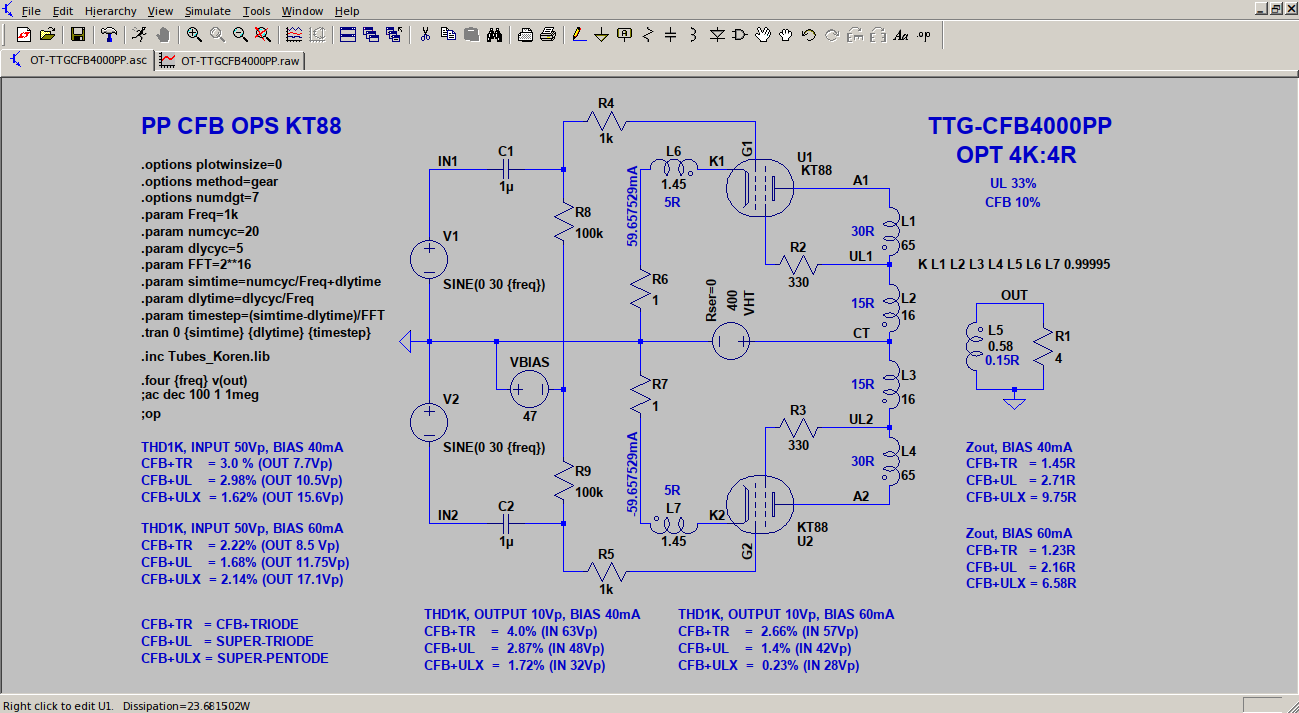

Which does not seem to correspond to the value used in your sim.
right, and now ?

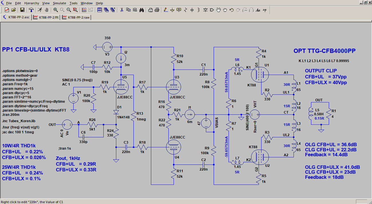

I looked at the simulation again (post 54), it was correct, so, my last OPT schematic is wrong (post65).
This is the simulation of the OPS . CFB and TRIODE connected KT88 don't like each other. In terms of distortion, super-pentode is the best (also the gain is the highest, the global NFB will be the strongest). When considering output impedance as well, super-triode is a best choise.

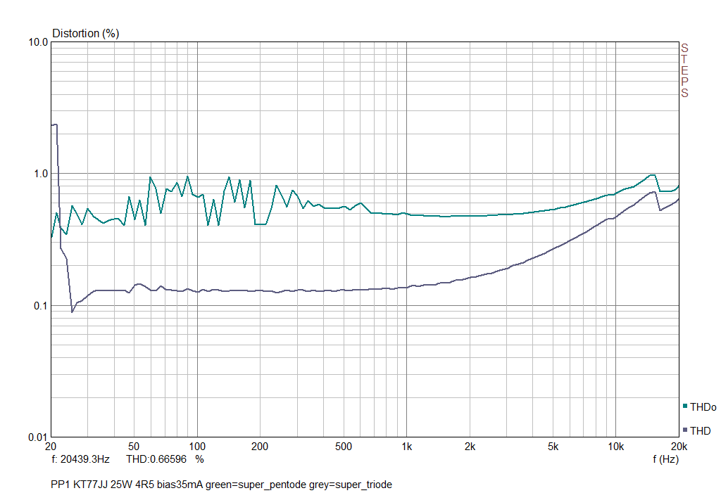

PP1 AMPLIFIER MEASUREMENT RESULTS
TEST CONDITIONS: B+ 400V, Global NFB 10-15dB (OPS configuration and tube dependent)
BEST OPS CIRCUIT per TUBE (in terms of distortion, dummy load 4R5)
EL34EH, BIAS 40mA
1. CFB+UL (best)
2. CFB+ULX
3. CFB+TR
KT77JJ, BIAS 40mA
1. CFB+TR (best)
2. CFB+UL
3. CFB+ULX
KT88EH, BIAS 60mA
1. CFB+ULX (best)
2. CFB+UL
3. CFB+TR
BEST OVERALL CIRCUIT and TUBE
THD 10W/4R5/1kHz
1. KT77JJ CFB+TR - 0.06%
2. EL34EH CFB+UL - 0.1%
2. EL34EH CFB+ULX - 0.1%
2. KT88EH CFB+ULX - 0.1%
3. KT77JJ CFB+UL - 0.15%
THD 25W/4R5/1kHz
1. KT88EH CFB+ULX - 0.13%
2. KT77JJ CFB+UL - 0.15%
3. EL34EH CFB+ULX - 0.22%
(no CFB+TR here, 25W is a clipping region)
CFB+TR = CFB+TRIODE
CFB+UL = SUPER-TRIODE
CFB+ULX = SUPER-PENTODE

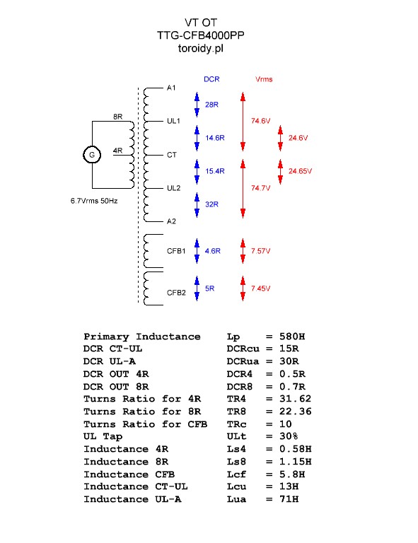

Ah OK, but what is not true is what they STATe in their website!!! It's not me. I had not noticed your reply in that thread. So Peter was right. I asked directly to Toroidy about that funny definition and they replied that it was indeed 10% Ra. Now it's clear that they do NOT know what they are talking about. I have to admit that Peter was right and they have probably copied the Plitron transformer. Bad copy of course, because the Plitron has quite better bandwidth and headroom.
I’m following this thread with great interest and trying to learn about CFB. Sorry but I did not follow your logic here. Would you kindly explain so a relative newbie could understand.
1. Why is the Toroidy definition funny? I looked at the Plitron transformers and to me it looked they stated the % CFB in a similar way.
2. I don’t understand why did you concluded that “they do not know what they are talking about”.
3. The Toroidy transformers are about 1/2 the price of the corresponding Plitron transformers. So, how bad a copy is it? From Toroidy specs the bandwidth seems good enough for me; the Plitrons go into very high frequencies but that may not be needed. Could you explain “headroom” you mentioned.

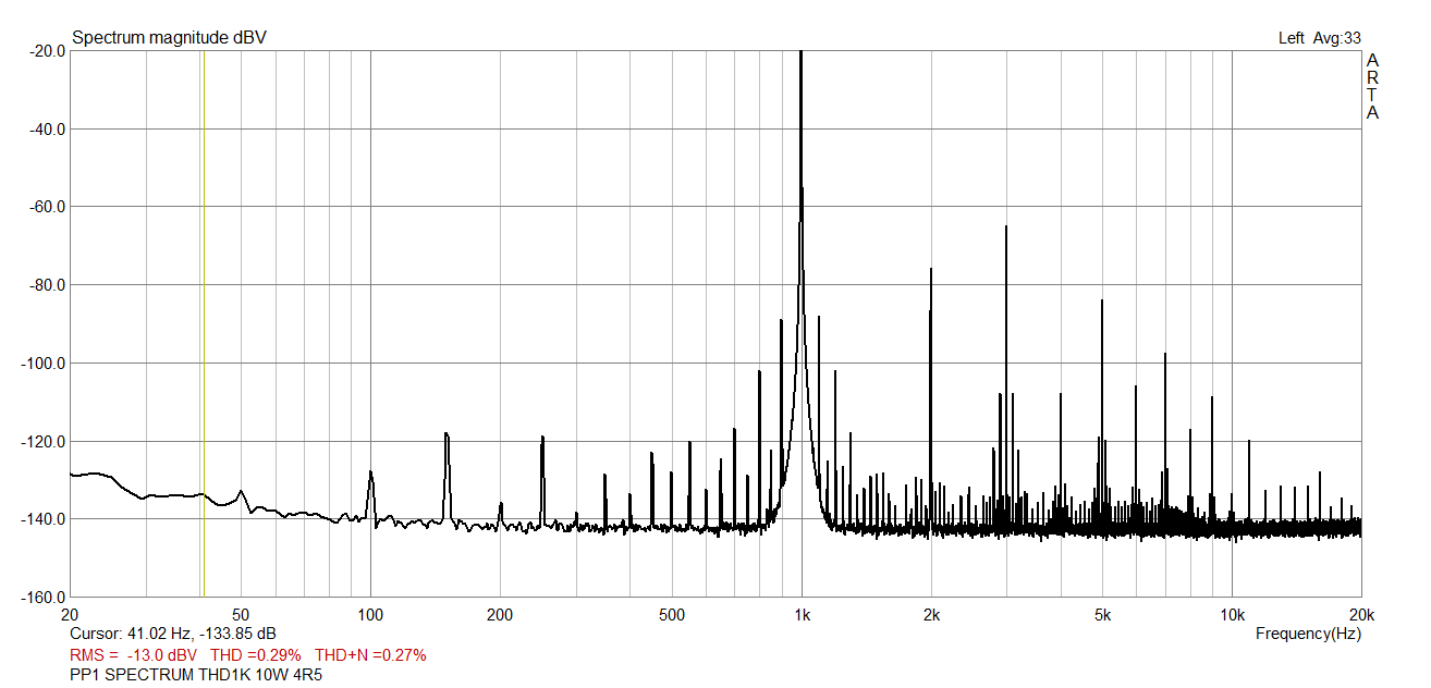

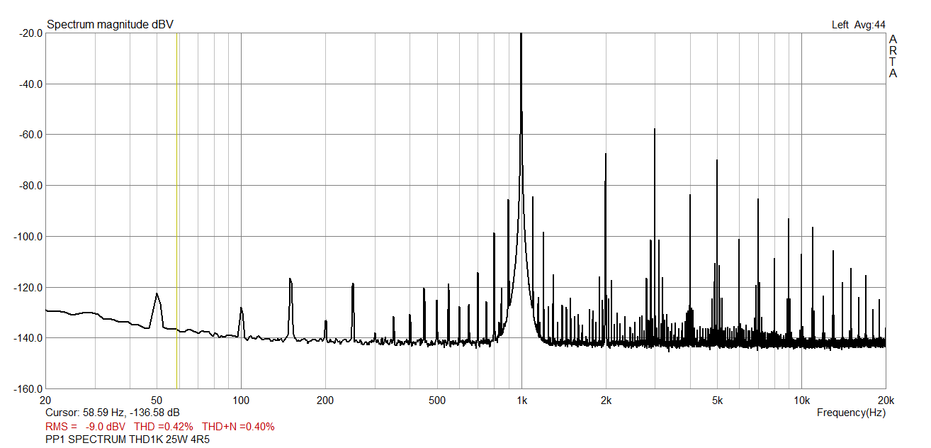

I underestimated my HT PSU a little. It's classic CRC circuit, 240uF-15R-240uF. Even though it has quite good ripple rejection this is not enough for PP amp. Specially, when talking about OPS IMD. Let's see what I measured.
OPS PSU RIPPLE
IDLE (2x60mA) 406VDC + 1.36Vpp ripple
LOAD 10W/4R5 398VDC + 1.64Vpp ripple
LOAD 25W/4R5 394VDC + 2.08Vpp ripple
Next, I measured 10W/25W/4R5 by ARTA.
Spectrum analyze revealed the truth. Rejection of mains related frequencies are good (100dB below fundamental). But, there is awful IM distortion caused by OPS ripple interaction with input signal. IM products are 77dB below fundamental and also surround higher odd harmonics.
This IMD is not related to AC heating, LTSpice sims show the same effect and near values (heating is "DC").
LKA - does ARTA measure specific IM response using 60/7k, 250/8k, 19k/20k test signals like REW ?
I believe your measurements relate to what is typically captured by the difference between THD and THD+N levels (where N includes anything else including hum and hum modulation of signal and its harmonics) - but perhaps you haven't set ARTA up properly, as your plots show THD > THD+N.
LKA, can you report the IM distortion results/plots from ARTA?
I think you will need to play around with your soundcard and ARTA settings, as there is something definitely wrong when THD > THD+N.
I suggest your point about power supply ripple and hum modulation of a test signal needs to be benchmarked as the difference between THD and THD+N, along with IMD measurements. Then the influence of changing power supply filtering can be gauged.

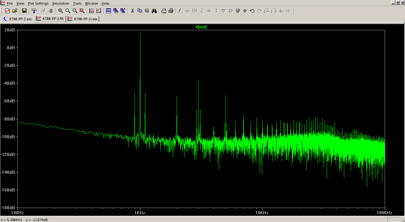

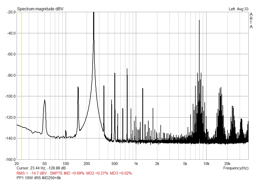

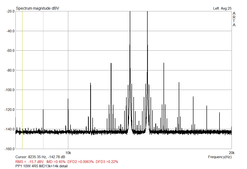

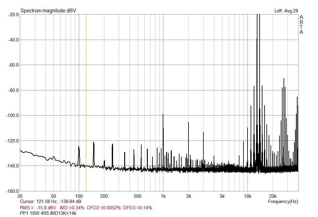

IMD measurements (input signal has two components, A and B) at 10W/4R5
IMD 13k+14k 1:1
IMD 250+8k 4:1
output signal has :
- A and harmonics
- B and harmonics
- IM products of A B
- IM products of A R(ripple)
- IM products of B R(ripple)
ripple is 0.4% of HT
PP1 10W 4R5 IMD13K+14k.png PP1 10W 4R5 IMD13k+14k detail.png PP1 10W 4R5 IMD250+8k.png
