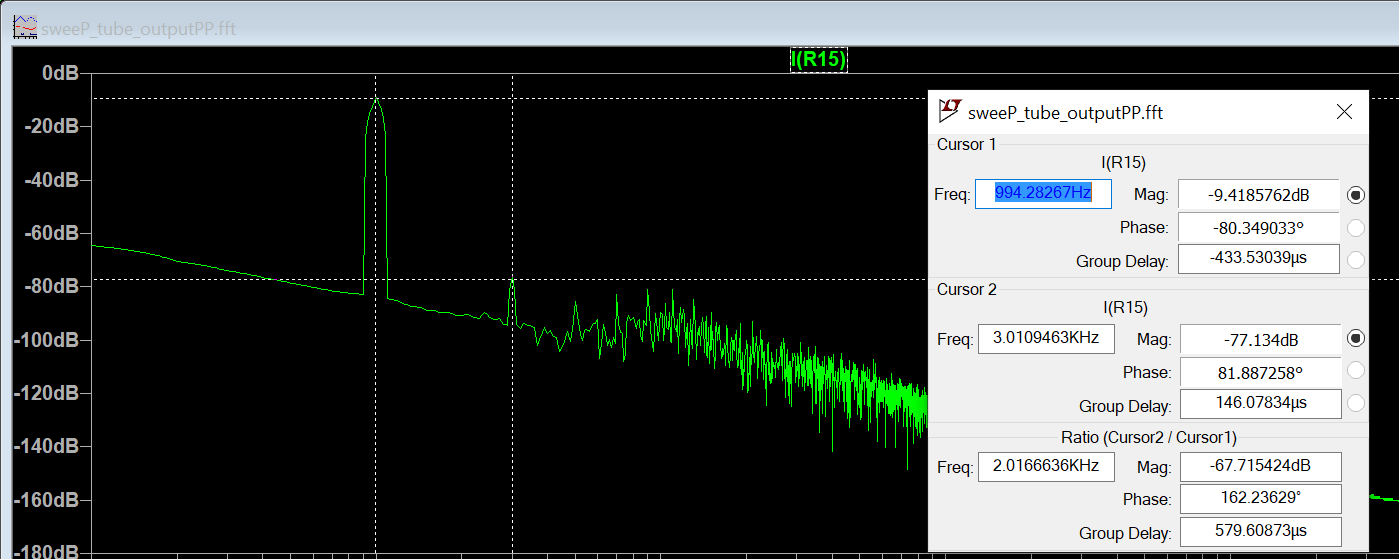

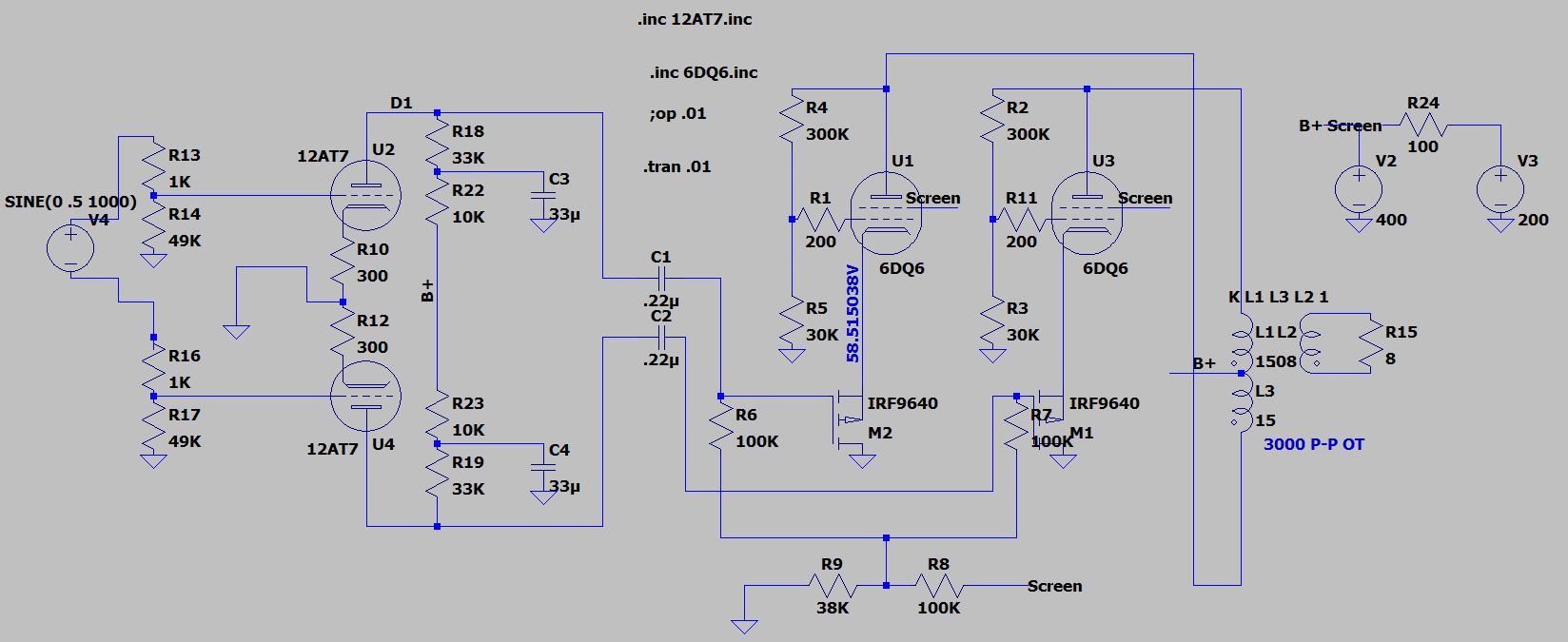

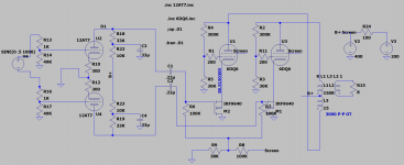

Review Design - Balanced input 6DQ6 UNSET output stage
Below is my current design. Using 6DQ6 in an UNSET output stage. Idle is about 17W (yes a little high) for a 50W output. Schematic and spice FFT sims attached. Driven by balanced output of DAC. Any modifications suggested?
Yes I would allow adjustment of the gate voltages to be separate with pots to set the current in each output valve. MOSFETS have a big spread of current which LTspice will not show. You could try ECC88 for first stage.
I'm not sure but check, V2 has B+Screen but there's B+ and there's Screen so I assume the to are connected but called the same thing?
