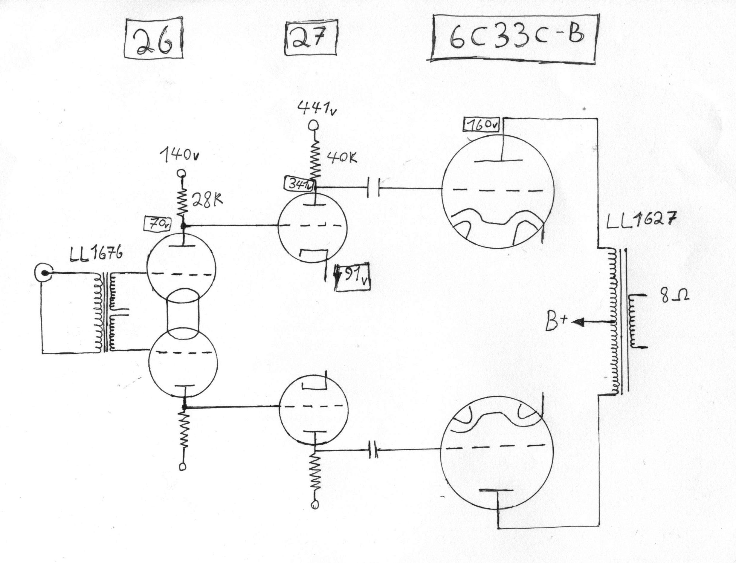

in the past fiew months i was tring to desing an amp that would have 30W/channel and would be all triod.
and i started to think about PPP 2a3, but this would be very expensiv and I will get berly 30W at class AB1.
so now I'm thinking about PP 6c33c-b that should give me 30W in class A1 and will cost much less!
It should be somthing like the schematic below.
(obviosly it is not a full schematic, it is just the idea of the desing..)
I still haven't desided what would be the operation point of the 6c33 (200V,200mA @ 600 ohm or 160V,300mA @ 600ohm)
all the power supplys will be regulated.
the otput supply will use a 6c33c-b as a pass tube for the regulation and the supply for the drivers would use shunt regularor tubes.
the supply for the 27 tube would be 450V that float on a 91v zener diode to avoid a capling cap..
(It should be 541v not 441v on the schematic)
now, the questions part:
1. is the schematic is fine?
2. should I go for fixed or self bias? (26 and 6c33)
3. what should be the size of the cap?
4. what operation point should i choos for the 6c33?
thank you very much!

If you don't mind I'll skip your questions. And ask you one. You do know that the 26 is a very difficult tube to get quiet?
Ok. I'll answer some questions.
1.) The essence of the schematic is good. Only you need to fill in the details. Such as the centertaps of the input transformer need to be grounded, grid leak resistors have been omitted, etc. etc.
For the rest of the questions I would find existing pp 6c33 amplifiers via google to get an idea of operating points and self or fixed bias etc. I do know the 6c33c has some quirks you need to know about.

thank you for your replys!
yes, i know abot the problems whith the #26 tube..
I would use a regulated current supply for the fill's. and if i get this right, the PP operation of the 26 should cancel alot of the nois, right?
ther is alot of things that is not conected in the schematic because i hadn't decided about them..
the input transformer's CT isn't grounded because i'm considering the option of fixed bias for the 26.

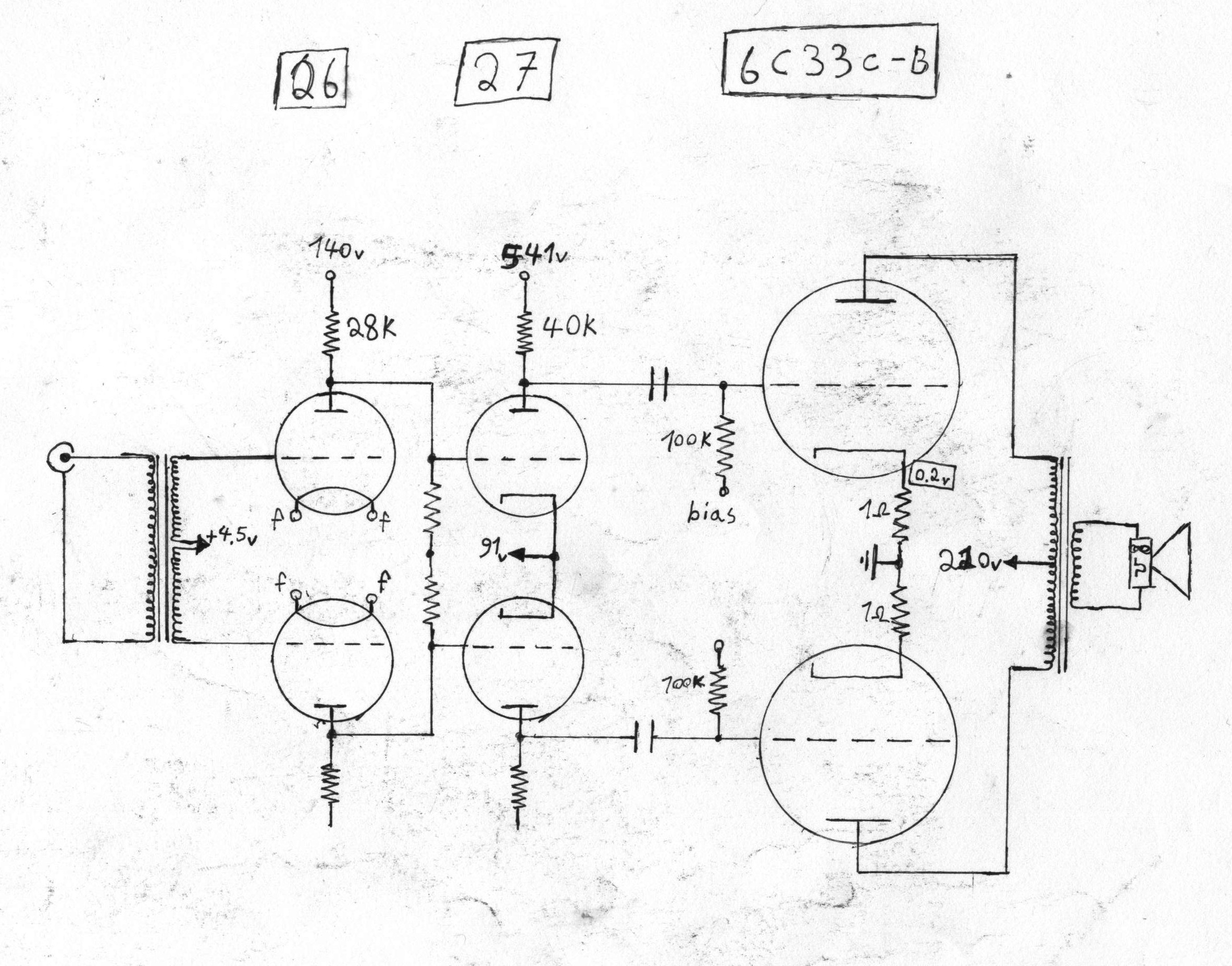

I added some parts and chose the operation point for the 6c33.
now I have to determin the value of the capling capacitor and the grid leak resistor (#27 tube).
questions part!
1. can you help me with those values?
2. do i need to conect the grid leak resistor to the ground or to the 91v of the #27 cathode?
thank you very much for your hellp!
