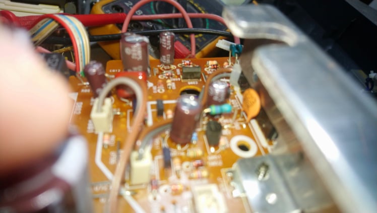

I have a Marantz MR 2020 (MR2021) there is dead
A fuse in the house installation was blown and all the power in the house was gone.
I replaced the fuse at got power again, but after that little episode the Marantz MR 2020 was dead.
I have tried to measure some voltage on the power supply, and found a "funny" thing.
In the schematic there is a point where there should be -27 V but i´am measure -43 V
I believe it is on the board (6.2) in the schematic the makes the trouble.
Here is a little cut of the schematic and also the complete schematic.
Can somebody help me to get this fixed ?

Then the 2SB1240 regulator pass transistor is likely to be shorted C-E, and needing replacement.
There may be other problems as well, if your house breaker tripped.

Just measured the 2SB1240 and between emitter and collector i measure 56 ohm - both ways

It's an ex-2SB1240.

Could have been a voltage transient, the Vceo rating is 32V.
Maybe the regulator's output to ground was (is) shorted.
That would impress the entire 39V across the transistor, not good.
Do some more checking before replacing parts.

Can you post a photo of the transistor and its heat sink?
Have you repaired pcbs before?
Ok, if you haven's reworked pcbs before, practice on some junk boards before doing this one.
