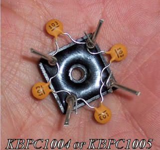

21vac x 1.42 = 30vdc
This is "close" so use with a "snubbed" rectifier, like this one pictured (click picture below).
You can use 10nF polyester for the snubs, if you like. They'll take off the harshest of peaks, take off some noise and drop the voltage slightly. Subtracting the noise will help keep your big caps cooler and last long.

Ok, I've used 0,1 µF caps on each diode instead of 10 nF caps.
What is the worst that can happen?

ace7one said:Ok, I've used 0,1 µF caps on each diode instead of 10 nF caps.
EDIT: There's no need to make the worst, because we have retail electronics stores for that.
Possible eye injury from an exploding cap is about the worst.
The runner up is weird frequency response abberations.
In third place, perhaps an awful smell that lasts for hours, along with a cloud of somewhat toxic materials.
For reference, 10nF = 0.01uF and they are printed with a "103" label on them.
From my observations and observed from a gentleman who actualy posted comparative scope traces... there is no real benefit going above 22nF..
Nordic said:From my observations and observed from a gentleman who actualy posted comparative scope traces... there is no real benefit going above 22nF..
sneih said:so complicated..........what's the true? 😀
Well, Nordic just did us the favor of stating the "large" size parameter. So, if you look closely, it seems that these capacitor values:
4.7 nanofareds or
10 nanofareds or
22 nanofareds or
anything between 4.7 nanofareds and 22 nanofareds
is the suitable size to snub a diode.

I'm after the clearly marked "+" and "-" on the plastic box versions of the 1 piece bridge rectifier. 😉
One of the square Kbpc1004 or Kbpc1005 is quite easy to snub for nice results with your center tap transformer.
-or-
Two of the "fork looking" Kbu1004 or Kbu1005 is fairly "explainable" for hooking up a dual-secondaries transformer. When reasonably placed side by side, presto! all of the connections become apparent. Then the 4 confusing wires of AC can get down to the necessary "V-, 0V, V+" for DC as simply as possible. I'm not going to snub that one.
