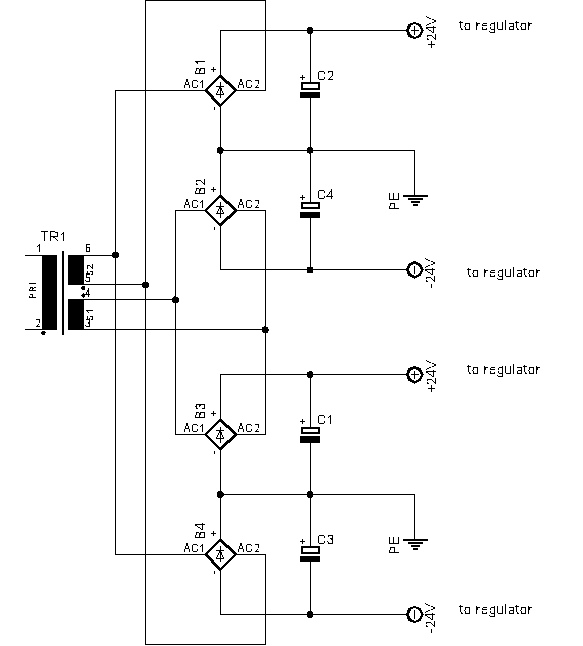

I have one trafo with two secondary windings feeding four rectifier bridges for two symmetrical regulated powersupplies like shown in sketch below. Something is wrong with this circuit because it trips the main fuses of any value. I also tried bare wire soldered across the fuse for a second (WARING- don’t try that at home) and seems like there’s a short circuit somewhere because tranny and bridges got really hot during that. Only thing I can figure out is maybe short in the capacitors. But the caps were fine before applying power. So I am clueless. Can somebody figure out what is wrong here?
Thanks in advance
Argo

Oh yeah, I must have been blind I just draw the sketch only after I wired the circuit. I wired it like this because it was more convenient (shorter wires, less mess). Very stupid of me :smash:.
I should have drawn the circuit before wiring and give a second or two of thought :idea: rather than second or two of shortened secondaries :redhot: :Ouch: .
Thanks a bunch for pointing out this error 😀

draw bridges like 4 diodes. Than you will find that you have parallel diodes pairs from different bridges thru the ground point. If those diodes haven't perfectly same V-I characteristic some current will flow thru ground connections from first to second PS and vice versa. This isn't good.
Regards
I see 😎 . Good point 😉
