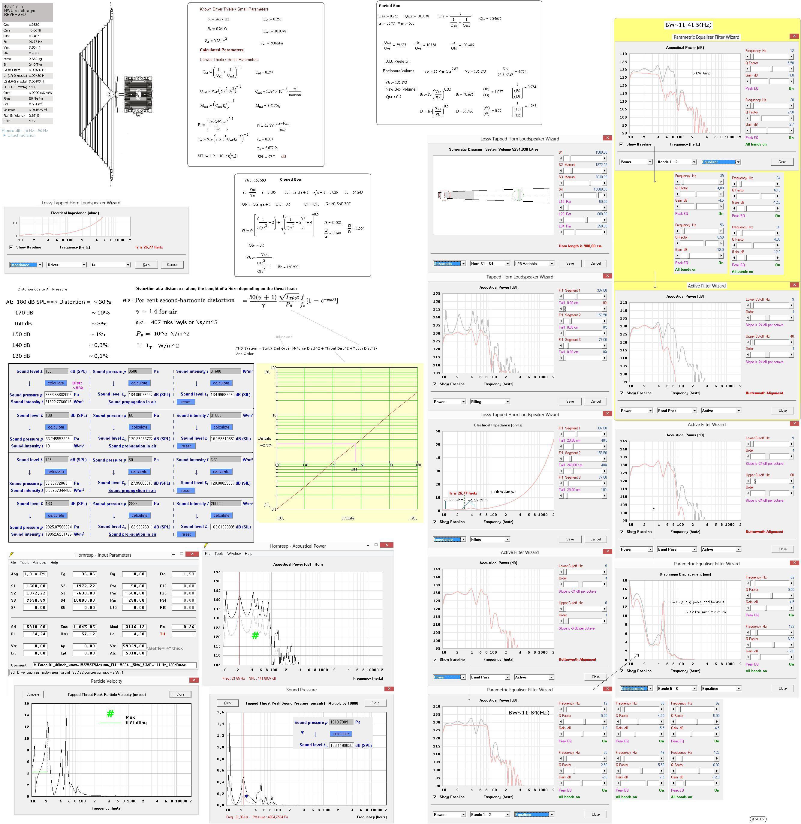

it looks like for the mforce 1, 40", reverse cone (3rd column) I've simmed a 1600 liter tapped horn (too much motor for front loaded horns...). it extends down to 29hz, and has 101 db sensitivity at the low corner (rising above to 103db at 70db, where tapped horns **** starts to happen).
It handles 65 volts... 15kw at impedance minima and stays within xmax of 15mm. 2 of them should slay 12 labhorns.... I only have paint on this computer. will post graphs tmrw
