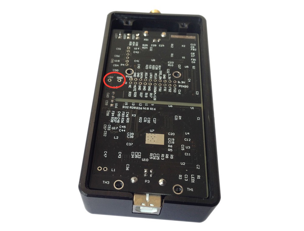

Can i use the inputs in the red circle in the attached image, to supply 5 Volts from a linear power supply to the Singxer F-1, or how can i do it??
Thanks for you help
Hi man.
I Read on headfi.org.
You should remove The rectangular thing from The board to power The Second part of The board..(rectangular BIG thing that connected between isolated sides of The board).
I also have The board.maybe best point to power it..
Correct - I actually contacted Singxer & that is what they advised. Remove the DC to DC converter (rectangular black box bridging the isolation area) & then it is fine to feed in 5v to the area marked (red circle)

I am Planning to power it with lt3045 regulator and battery.

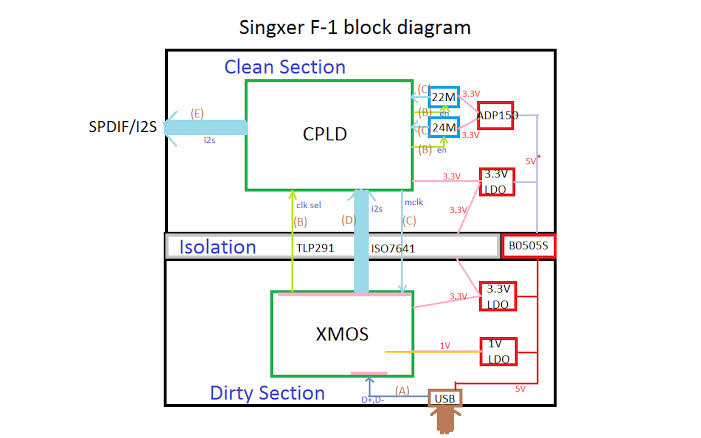

Probably after removed The rectangular box , Using 3.3v won't work,because Second part also need 5v..
People Using 3.3v just powering The clocks..

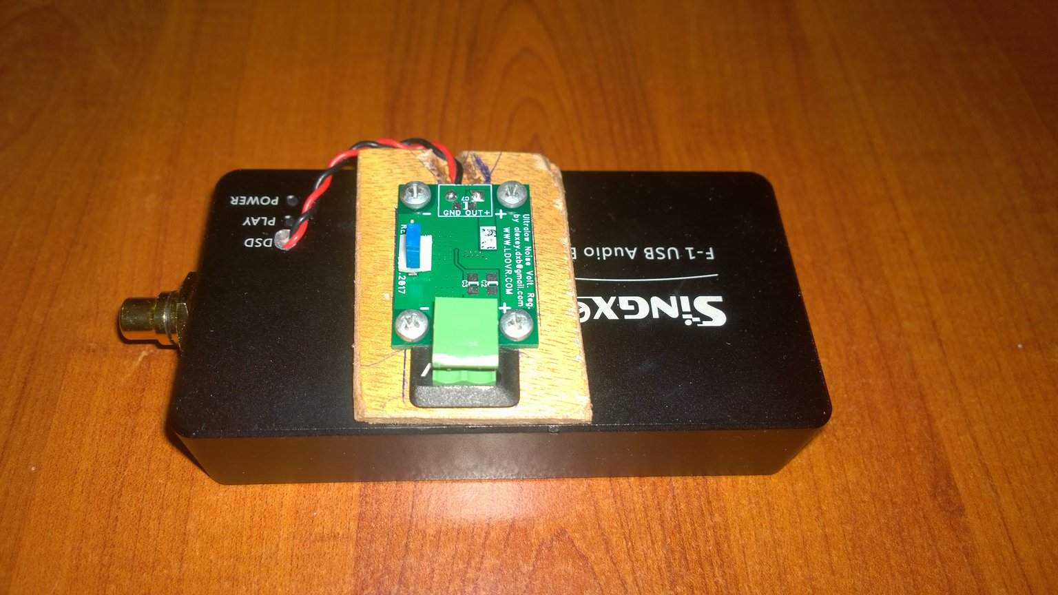

When I connected to power supply,power light goes on.
Probably it will work..
I power the all Second part of the board.
I placed pin header to 5v-gnd holes.
I used ldovr LT3045-S 5v board.
I didn't like 2 things about this board:
I couldn't find a toggle Switch will fit onto board(maybe submimiature ones fits..)
Secondly I didn't like the orientation of V and GND of the input section..
(in my opinion it should be reverse).
That's it.

No no No!!
In my opinion,it is essential to power First part of The board with a clean power!!
Clean power For Second part is almost useless without clean power For First part!!
Now I will try to power the whole board with usb split Y Cable..
I am not sure that also.I think I have some grounding problem.
So The most essential is to power The clocks and output section with a clean power.(it is my idea). 😁

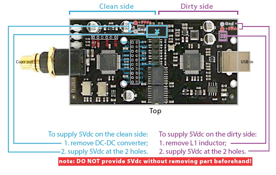

A very late update on this external 5V for Singxer F-1.
I successfully applied dedicated 5Vdc to both dirty side and clean side.
I used simple rectifier+filtering+LT3045 @5V output.
I did a diagram to indicate the solution.
The improvement is immediate.
The USB cable's 5V being cut off is a good trick.
Dirty side with clean 5V is surprisingly important.
I also add a 10,000uF/16V caps to each side.

I have seen that when connecting the card to external linear power supply the DC--DC converter should be removed and the L1 inductor should be removed as well.
However in this card there is L2 inductor
What it used for ? Should it be removed as well ?
