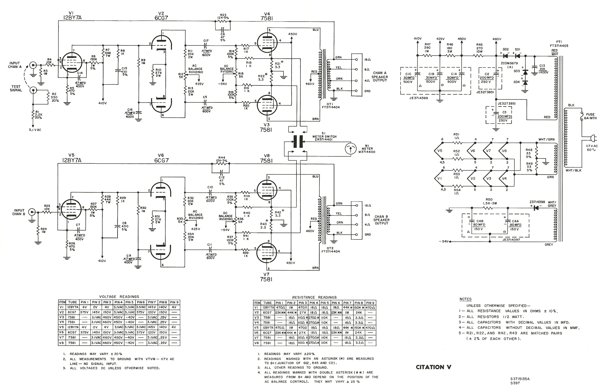

The requisite magnetics ("iron") make tube amps more costly than SS. What sort of budget do you have in mind? Given current realities, Hammond's 1650PA O/P trafo and a variation on The H/K Cit. 5 setup, with 6L6GC O/P tubes, is a reasonable possibility. The Cit. 5 is a superior implementation of what is known as Mullard style circuitry. Mullard style is "idiot resistant" and works well with so/so "iron", like Hammond's.

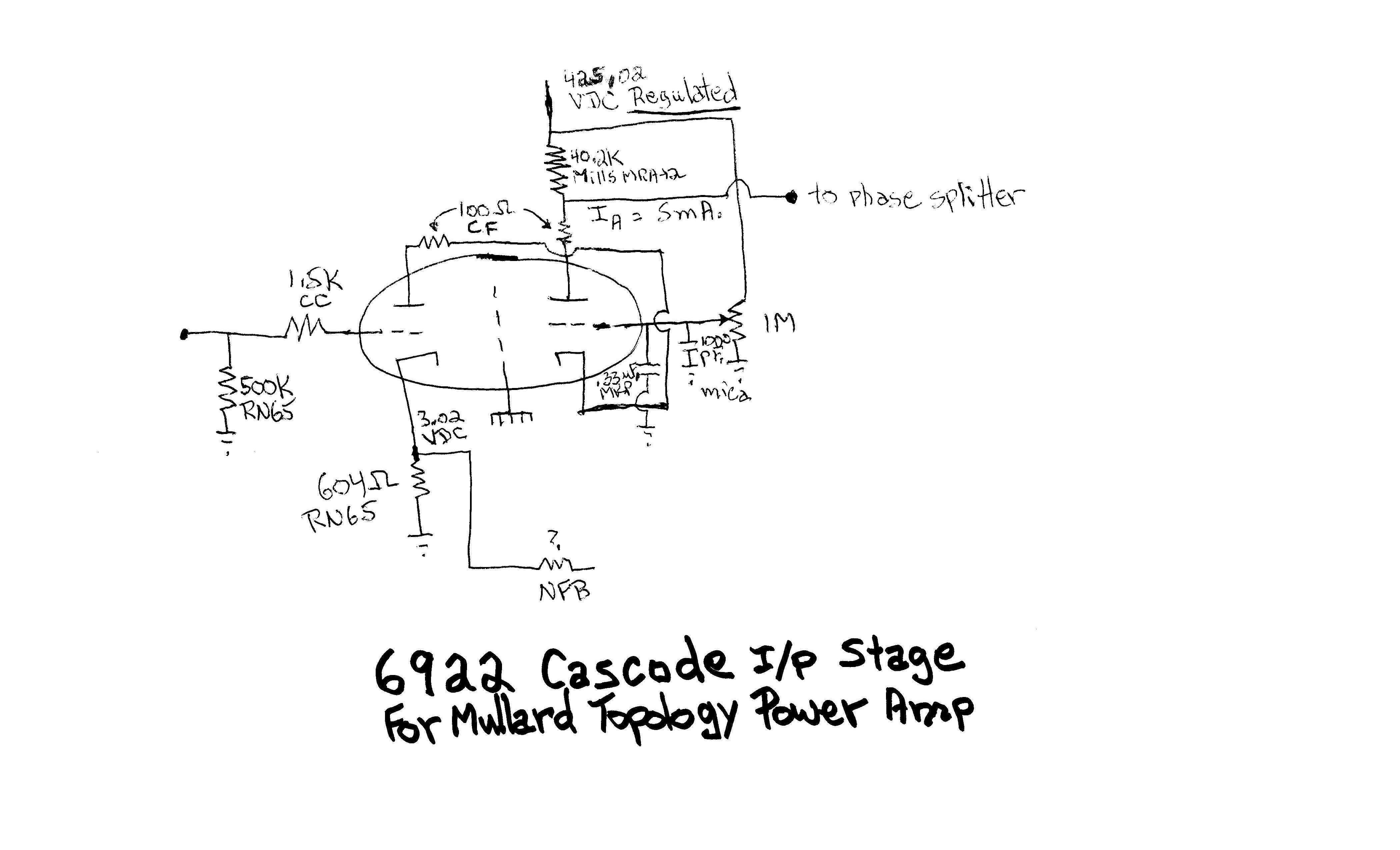

The 12BY7 used by H/K is getting scarce and is (IMO) best saved for already existing units. I've provided a 6922 cascode that will quite adequately replace the pentode.
