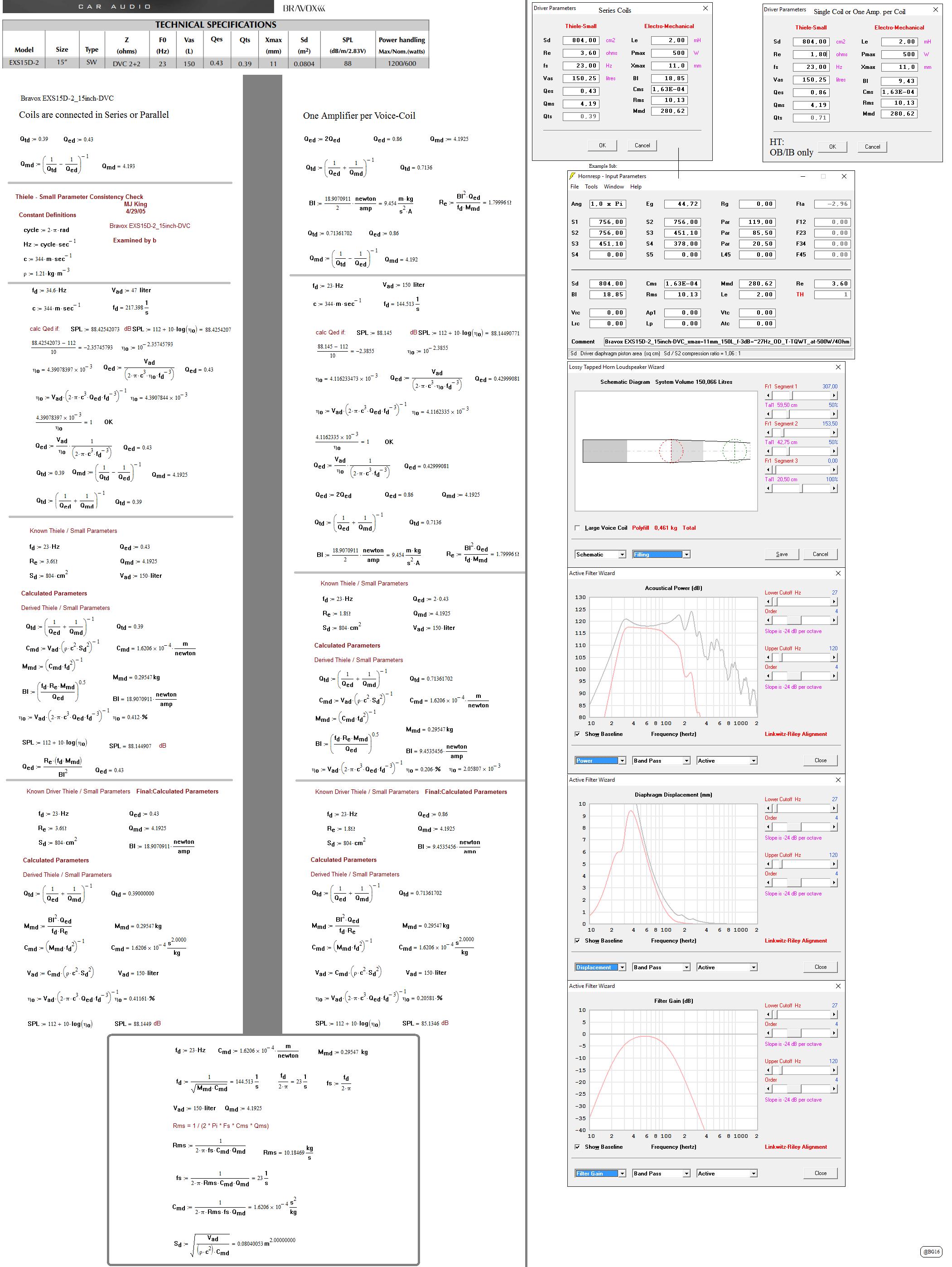

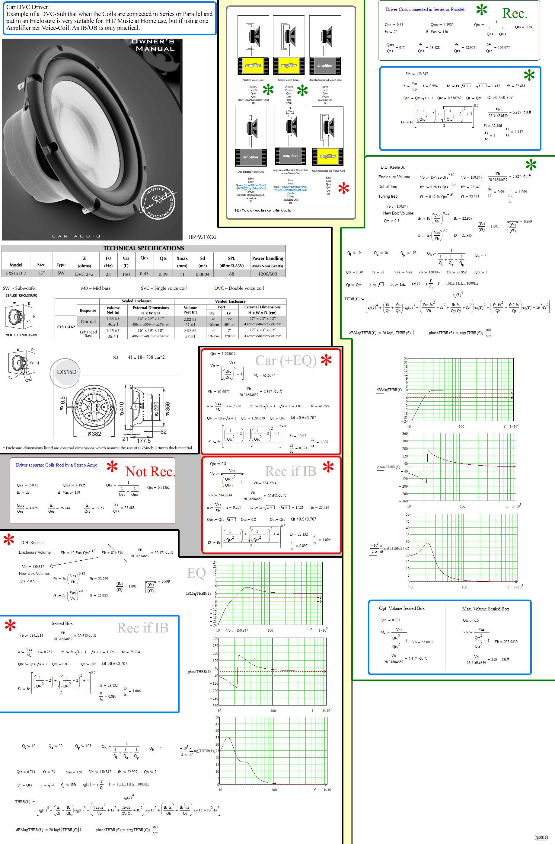

Hi luigi,
Have a look at my Pictures of a DVC Driver that I've investigated:
Maybe they will help you.
