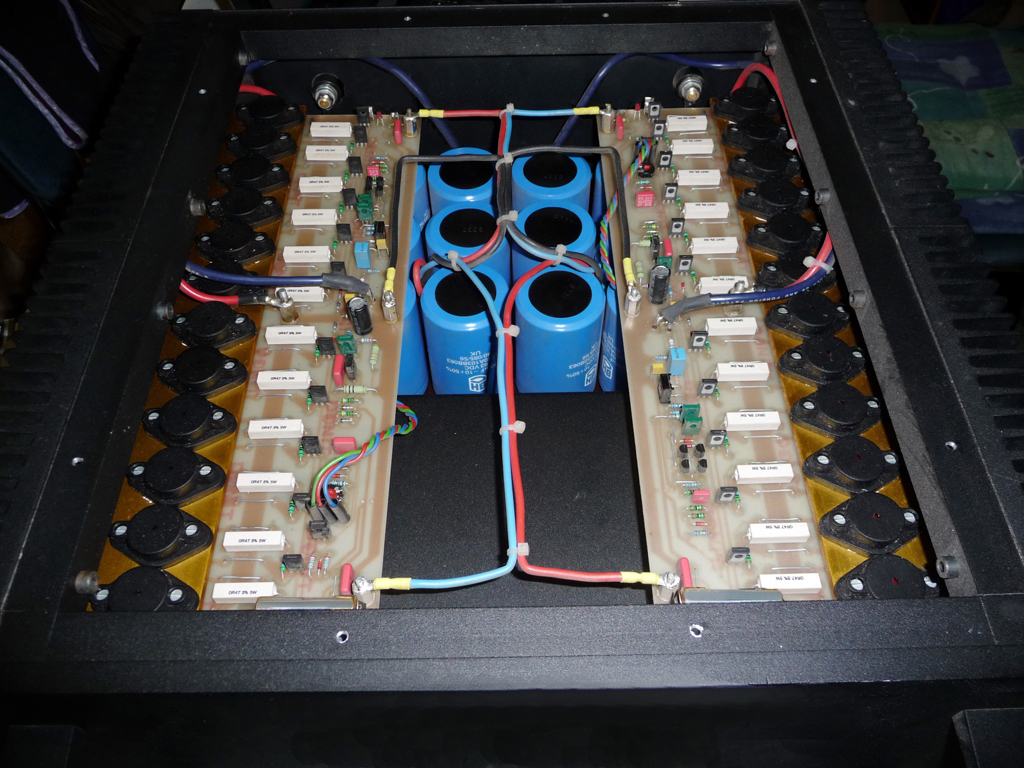

I currently still use the amps which I buy together with speakers, they are ordered by a previous user from a renowned German amp designer (he isn't with us anymore) and are made specifically for this pair of Scintillas incl. with a special low serial losses crossover networks.
I can only briefly specify its very basic specs. because I haven't any documents of it, but I do measure some very basic data a while ago just to have only a brief info.
1. No on/of switches - just 2. heavy cables hard silver soldered directly to multi-strand primary windings of each toroid power transformer (2 transformers inside each chassis - this call for a 4. wall mains sockets for two monos.
2. There are two 1500W toroids inside each chassis consisting only a sigle secondary winding of heavy gauge square wire - 35V AC output on an ordinary 220V mains.
3. Secondary wires are directly silver hard soldered to a 4 big Motorola bridge rectifiers connected in parallel to handle each secondary winding rectifying to a 50V DC.
4. All connections from a bridges to each rail bank - (120KyF Cap.) are made of a heavy silver passivated cooper brass in one piece and it goes all the way to under all power TO3 transistors which are also silver hard soldered theirs chassis onto a under brass - (for all the heavy traces it is used a silver hard solder instead of more conventional solder, perhaps of a better power transfer).
5. From the main filter banks there is a heavy coper wire to an additional 30KyF filter bank for each VAS stage and go forward directly to on board VAS stage un-fused. It uses also a separate heavy wire for a VAS ground.
6. From all the outputs of emitter resistors again is used the same heavy cooper brass - and again silver hard soldered and go directly to custom machined output terminals. The amp doesn't use any protections at all, just purest possible straight path to the output.
6. There isn't any switch, fuse or whatever used in this amp.
7. For power up procedure there is another small transformer with some kind electronics which slowly charge with very limited current the main and the VAS power supplies. When they reach the full supply voltages the four green led diodes indicate I can safely insert power cables in to the mains wall sockets.
8. While in daily use the amp is all the time switched on, if I don't need it for a few days or a even for longer period I just pull out the main power cables and live it powered with this secondary power source just to be in some kind standby mode.
9. This way it is ready for very quick working condition again on the next needed power on state.
- It has a very brutal raw power and the bass is exceptional, it is aways an air flow feel around the legs-trousers moves especially if there is a Reggae Dub music test (Mad Professor) for the source.
I would like it to have some more gentle civilized sound like this Acuphase power amplifier which I have a chance to test quite a while back - neck by neck with my amp. The Acuphase amps are able to play with my speakers the most pleasantly music from all amps I have chance to bring them home and test them with my Scintillas. They are also the only ones who was able to drive my speakers very loud for a hefty 30 min.- and they also switched off being too hot. The Mad professor Dub reggae test was too much for them also.

Reading through that last post, I see a continuing theme.
Avoid current limiting at any cost. This is applied to both protection limiting and resistance limiting.
The sooner all amplifiers are designed to deliver adequate current into the specified load, the better for High Fidelity.

Hello Smiley,
Agree on the sound of the Accuphase and nothing matches the clarity of sound like a direct drive ribbon IMO. As to your amplifier, i would step away from the mallory's they are not noted for good sonics ...
Could you post a pic of your arc welder ( amp) ....🙂

Agree with You, Accuphase was my the beauty-est sound experience. And there is only one more better speaker made in the term of real Life-Like feel of sound - Apogee the Grand. I can't imagine how would they sound in eg. active 4. way multi-amped
In my amp there are only the heaviest BHC-Aerovox El_caps no Malloryes at all ?.
Do You think maybe Motorola bridges ? They are the highest ratings available from the time.
But one is for sure, there isn't any plastic transistors avail. to handle the peak instant heavy currents like the TO3 can.
I'll post a pic when I'll come home, right now I'm on my restful place for some 12 days.

Hello Smiley,
You must be well rested by now 🙂 any chance of pics, would love to see the insides of that beast ..

:emoticon: Indeed, here is the one of the two little ones who can do . . . . :cheers:
