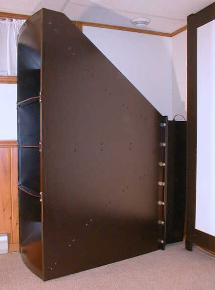

rcavictim said:I cannot understand why they would have discontinued such a fine and very affordable compression driver.
That woofer looks like it is capable of exposing the cabinet weaknesses of any A-7 box. Nice!
I think it is just the evolution of a product. The 205 was old the 210 is new, and costs more, gee.
Those woofers have a way of making the cabinet into it's own resonant chamber. It's like the walls are their own passive radiators when you turn it up. No those cabinets weren't quite made for the woofs but what the heck, they're only for partying.
And besides, the girls like them. They're forever leaning against them. 😉
