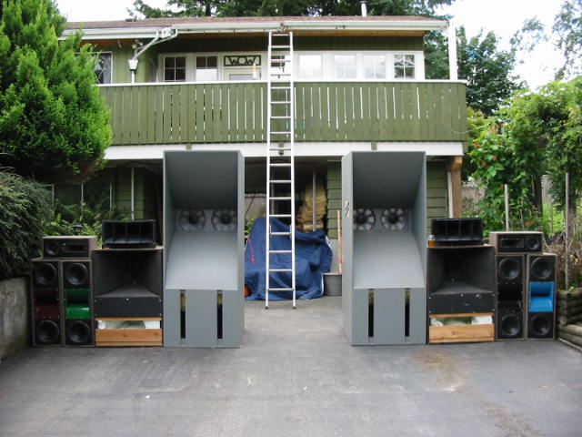

Another option is to get some old cabinets and refill them with updated gear like I did.
Cal
Sheesh!
Cal, You'll pick up a lot of outdoor useable bass if you put 4x8 sheets of plywood (wings) on each side of those 210's. That was an Altec option.
What do your neighbors think?
Hi rca,
I've oft thought of the plywood wings. Putting them on hinges in fact, so I can fold them back easily for storage.
But if you think I'm short of bass well, perhaps you should hear them first.
Neighbours? Don't know, I can't hear what they are yelling. 😉
Cal

Hi Magnus,
The horn ports were painted four different colours because I was using up some old cans of spray paint (not kidding). Those are bass reflex ports not HF. They are small bass boxes (dual 10") and they go with the small mid/high units on top. Great for small venues. The A4 and A7 boxes get put together for another system.
All together they make up my "Speakerhenge"
Cal
Cal
So Cal, are you using horn flares as ports? I just assumed they were HF horns 'coz they look pretty much like miniature 2380 flares. Anyway, the color coding scheme would work great for easy identification I guess.
Are there something like an 8'' and piezo horns in the small top boxes?
What amps and crossovers are you using for this setup?
/Magnus
/Magnus

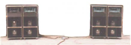

Cal,
Here is my outdoor party system. I built it for a video roadshow system I built into a 5 ton straight truck a long time ago. I also have an Eiddophor light valve video projector that can do a full drive-in theater screen at normal brightness that runs off a silenced 15kW genset on board the truck. Anyone wanna buy this from me? 😉 I have four A-7's each driven from a 100 watt SS Altec 1594A mono power amp. Below them I have four Altec 816A bass bins each containing a 421 8H-SII woofer. An Altec 9440A, stereo power amp provides 200 watts RMS for each bass bin for a total of 1200 watts RMS. It can ruffles your clothes at 100 FT. I run the A-7's full range and have an active LPF to drive the bass bins. I set the ceiling on those at around 300 Hz. It is my workshop sound system now mostly collecting dust and I actually havent used it outdoors as intended for about a decade now.
This system sounds extremely good as you know....outdoors.
I had an opportunity to acquire (cheap) a pair of 210 cabinets loaded with 515B's and with the huge multicell topboard horns and drivers ( the A4 system) when I was building this system but could not physically handle them myself so I passed. 🙁
Sorry for the crappy picture.
