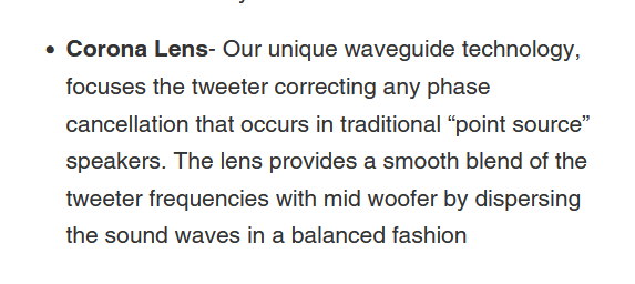

MX Series of Full Range Speakers feature a Dual Concentric Coaxial Design which allows the sound of each driver to emanate from a single point, eliminating frequency interference and phase issues. Corona Lens allows for better off-axis listening by producing a uniform and articulate sound field in all directions, resulting in correct phase and improved time alignment. These features are combined to create an engrossing listening experience with detail, impact and tonality unrivaled from any other speakers in or even double MX’s price point. The MX drivers will be an easy drop-in replacement with an excellent increase in performance and sound quality from stock locations.Features
- Shallow Mount- Allows for easy installation behind factory panels
- Dual Concentric Design-Provides excellent off-axis response as the woofer and tweeter share a common center thus focusing the sound of both drivers in a uniform field of sound resulting in premium sound quality from stock locations
- Polypropylene Carbon Impregnated Cone- Strong yet lightweight material for crisp, accurate mid and low notes
- High-Temperature Voice Coil- Our proprietary Torriform Technology provides superior current distribution while effectively dissipating heat
- Phoeniroll Surround Technology- A Phoenix Gold Standard that supports smooth linear movement for optimal accuracy
- Silk Dome Tweeter- delivers rich, warm treble with remarkable clarity and definition
- Corona Lens- Our unique waveguide technology, focuses the tweeter correcting any phase cancellation that occurs in traditional “point source” speakers. The lens provides a smooth blend of the tweeter frequencies with mid woofer by dispersing the sound waves in a balanced fashion

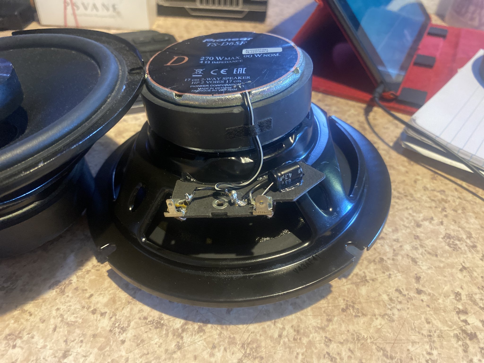

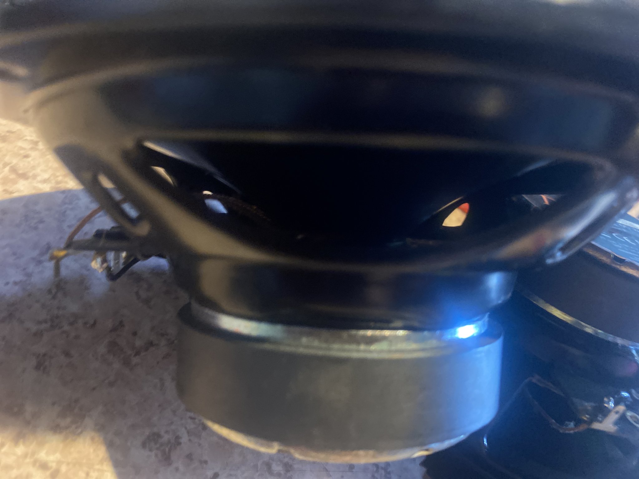

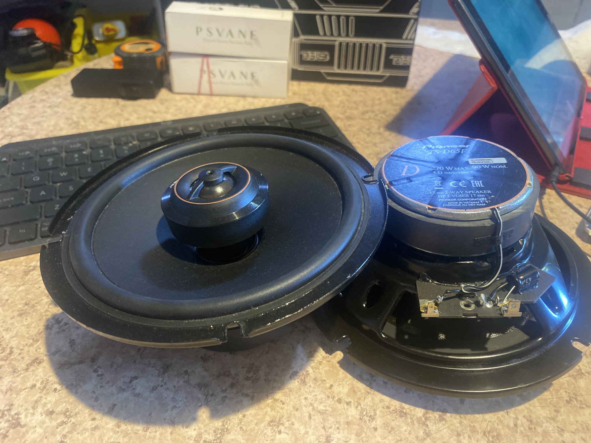

The Pioneers do sound better than the Phoenix Golds. My hesitation was the pole stem and thanks to @Patrick Bateman, my fears are unfounded on that. I'll see if those drivers can be made to sound and measure well on in a cab. Then will use it as a reference sound to see if I can tune my coaxial concept to sound and plot better
If a monohull takes too much power to break hull speed, split it up and make a multi-hull that will fly with less power. To get a different result, change the rules!
Cleaned up the Pioneers. Check out how they have the cone shape, stem and tweeter. It sticks out forward of the roll surround. The terminal strip is very accessible, and the capacitor can be removed for biamping for electronic time alignment. I'll use that option. If I can get the cabs right, these have the potential to replace my current setup. It might be overkill, but I can't think of a more value or reliable option that to give these a FFA001V3 H/B module, a 1.1 DSP module and a tube line stage per cab
