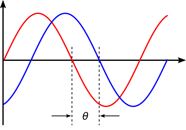

It says that a filter does phase change at a certain stage
Odd order filters do 270° and 90° and equal order 180° and 😱 360° ( I didn't know that with cascaded 2nd order filter you lose a full period)

phase quadrature - Google SearchHi thanks a lot for the valuable advice. I read that a 24dB/octave filter keep the phase the same ? and that a passive 24dB/octave filter xover is very difficult to design/build ? i see that many active xovers are of this kind.
It is 360 degrees out of phase.I read that a 24dB/octave filter keep the phase the same ?

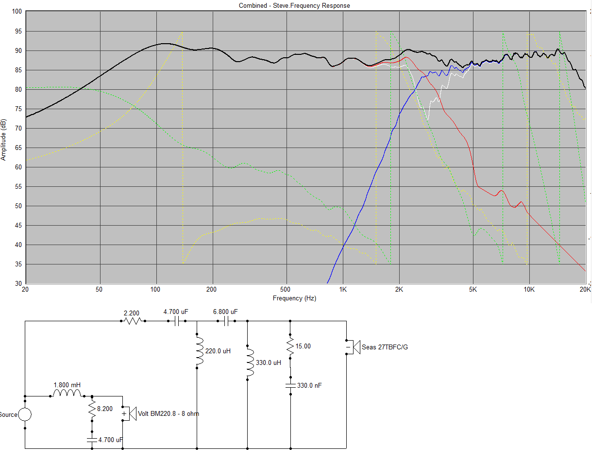

Here is a random example (original post).
Maybe you should have mentioned that the white trace is the sum when the polarity is wrong.

Thanks ! can we say that when the FR is fine and distortion is low as well, then phase is no problem ?
