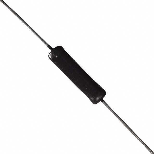

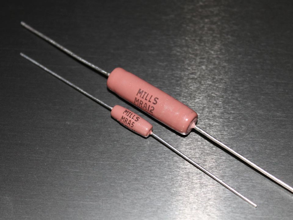

Vishay/Mills resistors. The Vishay industrial package are black coated. The Mills are brown enamel. Mills resistors would be more known to you as they were very popular for Zobel networks in audiophile crossovers.
Vishay labelled resistor (MRA12):
Mills labelled MRA5 and MRA12:
I know there are other manufacturers for them. But these are the best ones I found several sources that sell them at reasonable prices. Granted I could go to an audiophile parts site, but you always pay a premium price there.
Ah I recognize those, but not from audio. Saw them before in RF equipment. Makes a little more sense now.Vishay labelled resistor (MRA12):
