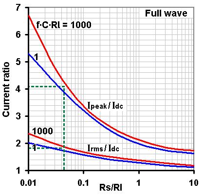

My wondering may be explained by the difference in post rectifier smoothing capacitance.
The capacitance has a fairly small effect on the PF (but yes, less capacitance does mean better PF). The bigger player is the ratio of the source resistance of the transformer (and any other resistance that comes before the cap) to the load resistance. The lower traces on this graph would represent PF if you inverted them (Idc/Irms). You can see that when the source resistance of the transformer is much larger than the load resistance, the PF will approach unity.
A PF of 0.66 is exactly the sort of figure we expect for an off-the-shelf transformer operating at its full design rating, since it will usually have an internal resistance that is about 0.15 times the load resistance, giving a transformer regulation figure close to 15% which is typical. Looking at the graph, Rs/Rl = 0.15 shows the RMS current in the transformer secondry will be about 1.5 times greater than the DC load current, which is a PF of 1/1.5 = 0.66. (Primary magnetising current also worsens PF, but this should be a fairly small contributor when under load)

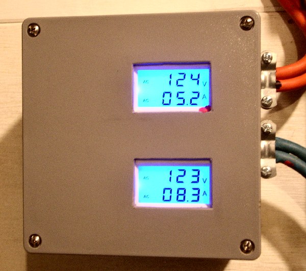

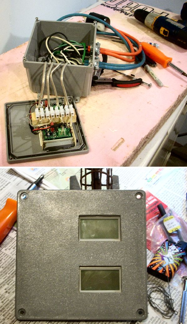

I bought a power meter.......
Being in 120 land, I bought two similar units, and wired them into my cellar fusebox.
(Lurkers: do not try this at home! Do it at someone else's house!)
No "power factor" (the traditional meaning of large shifty motors has been clouded by distortion; and I hardly care).
Knowing my voltage and load real-time has been moderately useful.
For your purposes, a "Kill A Watt" monitor is a pre-made and useful tool. I have used that to estimate the duty-cycle of a refrigerator. I have also cut a cord so I could use my Fluke to get the starting-current of the reefer.
FWIW: the two I bought, one had a flaky back-light. I bullied it into working, but 2 years later it is out again. I have got 2 more of the "same"(?) unit, but not yet replaced the dim one.
