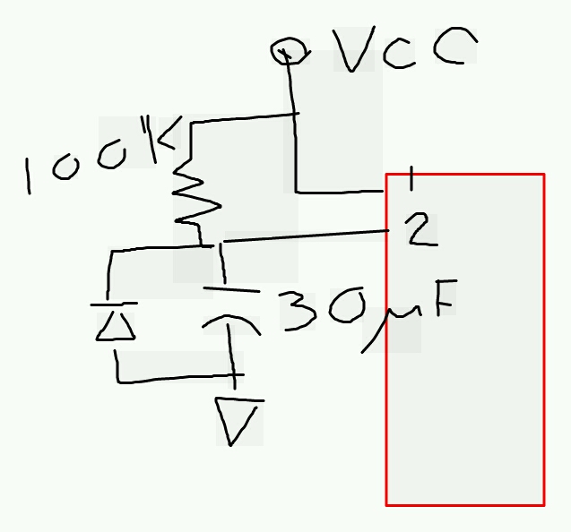

Why not just an RC as I suggested earlier ?
No need for switches.
I would also put a diode across the resisitor to discharge the capacitor on power down.

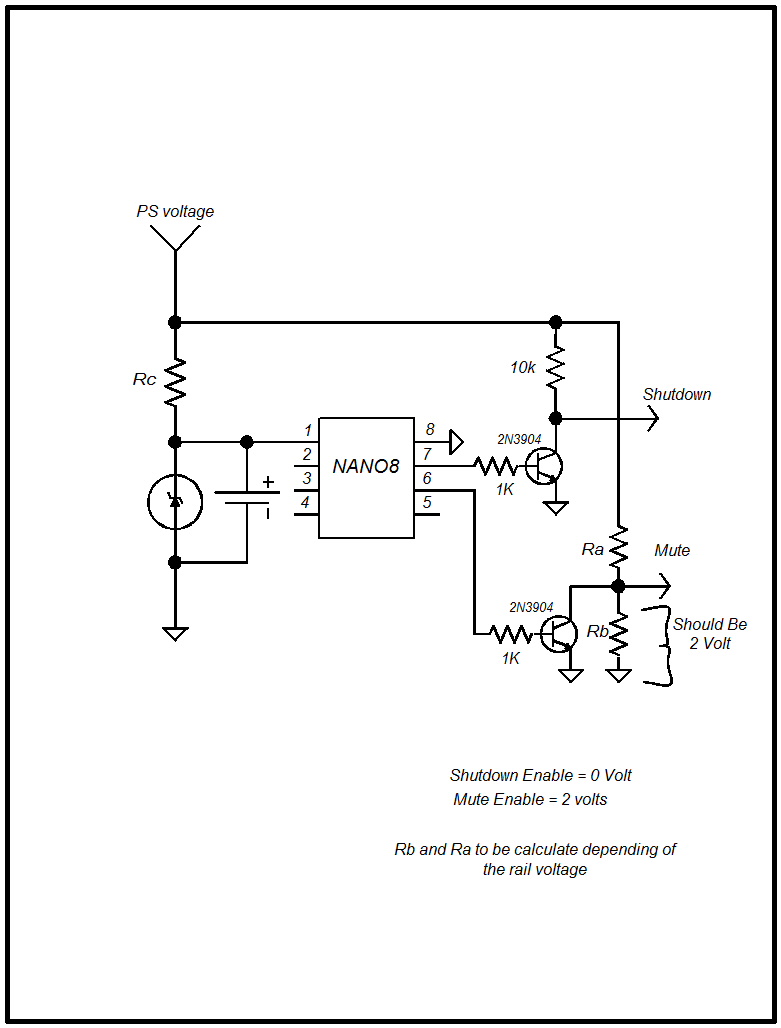

Just to show how easy it is done using a micro attached it is an schematic showing the way I will implement it using the Nano8.
Also here it is the program use to control the mute and the shutdown.
Nothing to it. Also this can be use to control any amplifier start up.
'This program will control the mute and the shutdown
'At the turn ON of the amplifier
Main
High P0 'Enable shutdwon by applying 0 volts to the shutdown pin 2.
low P1 'Enable mute by applying 2 volt to the mute pin 3.
Pause 10000 'wait for 10 seconds to allow the PS to settle
Low P0 'disable the shutdown by ampplying the rail voltage to the shtdown pin 2
high P1 'disable the mute by applying zero volt to the mute pin 3
stop

You don't have pin 2 (SD) shutdown connected to anything here. SD needs to be held high (greater than 2 volts) a couple of seconds after power is applied to Vcc. I agree no switches if you use a diode or resistor to drain capacitor. Your 10 uf and 10kOhm time constant is only about 70 msec, is that long enough for SD circuit to latch while power stabilizes?
Here is a sketch (sorry it looks so bad, all i can do on android tablet).

A PIC is a microcontroller with built in A-D and D-A conversion. He's using it to give it some 'smarts' - watching when power is good and so forth. There are a tremendous number of possibilities when adding a computer to the project. If it sounds like overkill it actually isn't and you'll find a bunch of things you may have thought about but didn't bother with because discrete logic can turn into problems as well and what's worse, logic gets corrected with 'cuts and jumpers' whereas logic errors in your controller just get erased and re-programmed. The same controller can also be used for remote control and other interfacing.

In the schematic the shutdown pin 2 it is connected to the + voltage means that the shutdown it is disable. Zero volts means enable. The mute pin 3 it is connected to ground. Zero means that the mute is is disable. 2 volts means that the mute it is enable. How much voltage your are using in you PS? I may come up with a schematic using the basic micro. I can make the circuit using the micro basic nano 8 if you are interesting. I will programming it for you. It is a simple program.

My sketch in post 23 shows how to connect it, but I am not sure I did the diode correctly. I know if you put two 1 Megohm resistors in series where the diode is it should work. You need 100 kohm, 2 x 1 Megohm, 1 circa 30 microFarad 35 volt electrolytic capacitor. Connect them as shown between pins 1 and 2 with Vcc on pin 1 and ground on the negative of the capacitor and the two 1Mohm resistors. Basically, it is a 2 second timer circuit to allow the amp to stabilize before allow the shutdown SD input to go high logic. Vcc is your positive power supply rail.
Good luck.
Let's see if I understand this
XRK
I printed out your circuit and thought about it more carefully. Let's see if I understand this. Please read carefully and see if I do.
In layman's terms, I am to:
1) Attach one end of a 100K resistor to pin#1. Other end to pin #2.
2 On the resistor lead, at the pin #2 side, solder the negative end of a 30uF (what voltage?) capacitor.
3) Run the positive lead of that capacitor to a ground. (Question: Where is this ground? Note that I am using a wooden enclosure.)
4) A diode jumps/parallels the capacitor. The striped end of the diode attaches to the negative of the cap, and the other end of the diode also attaches to the ground.
Can this ground point simple be a screw driven into my case/enclosure?
Am I understanding it?

The positive lead of cap goes to pin 2, neg to ground. 2 x 1 megohm res connect to pin 2 and to ground. 100k res from pin 1 to pin 2.

I double checked my math and it also depends on how many volts you are driving it with as that affects how fast the cap charges up to the 2 volt logic level.
The equation for the voltage at a capacitor in an RC circuit is:
Vc = Vsupply x (1 - exp(-time/RC))
rearrange and solve for C we get
C = -time / [R x log(1-Vc/Vs)]
So assuming you are using a 12 volt power supply, Vc is 2 volts, time is 2 seconds, and R is 100 k ohms, solve for C to get
C = -(2 sec) / [100000 ohms x log(1-2/12)] = -2 sec / (100000 ohm x -0.182) = 110 micro Farads
So something bigger than 110 uF should work. Of course if you are using a 24 volt supply, you need to double the capacitor size.
