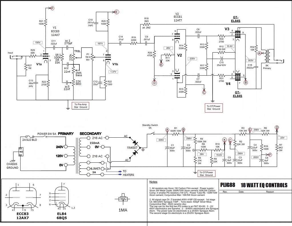

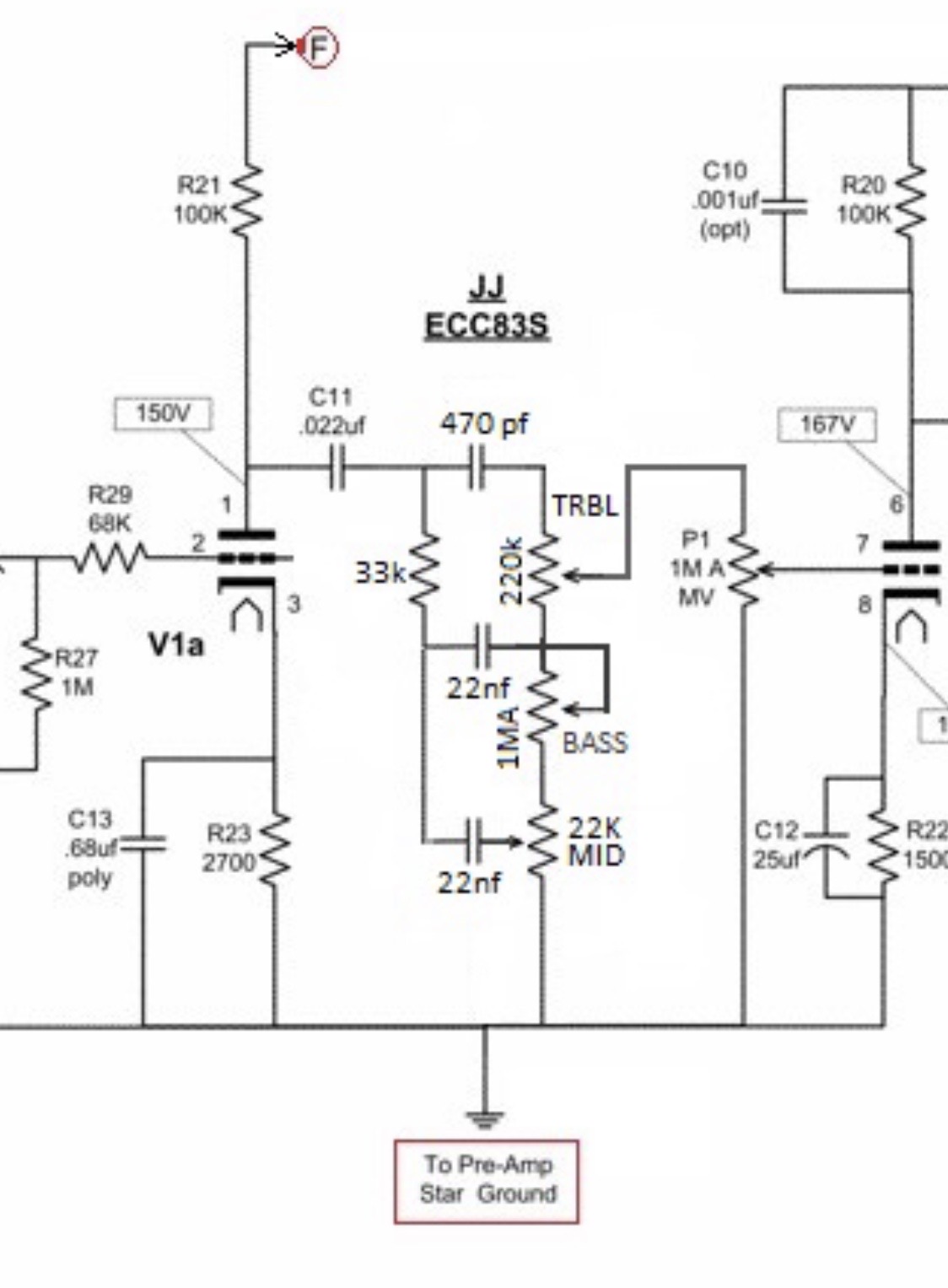

Thank you very much nice and small but I build the Phoenix . Now I’m searching to build a simple EQ after to 1st 12ax7 . Just a bass - middle - treble .

Bassman (Marshall) tone stack
Fender Blackface values.
Ohh now I see .. thank you Printer2 for EQ . I have build 2 amps as well at 15 and 18 watt , I don’t need more . But I just want to make something with less gain stage to add pre amp emulator pedals … but now I’m ok with Phoenix .and I put the EQ for something different from my other amps ..

this is what I wanted to know, whenever for less gain I will remove the capacitors from the grid of v1 (pin: 3-8)
And something else the schematic of Phoenix say to some grounded on OT/power ground and some grounded on pre amp star ground . normally everything has to be grounded with the chassis. Why here he groups them?!?!

Personally I would build it in full, to use as flat power amp add a switching jack feeding the volume pot and bypassing first pramp stage, BUT you can also use it on its own in an emergency.
220+220VAC with SS rectifiers will give you needed ~300V DC

For testing I take a transformer with 24v + 24v output .. I put on one ac cable the 1n4007 and on the second the another 1n4007 and those 2 cables with diode put it together .. the current drop to 23.05vdc . why? As you say I use 220v+220v with couple of 1n4007 the current goes around ~300vdc .. I.e. 1.41 x 220 = 310 vdc … what I’m do wrong ?

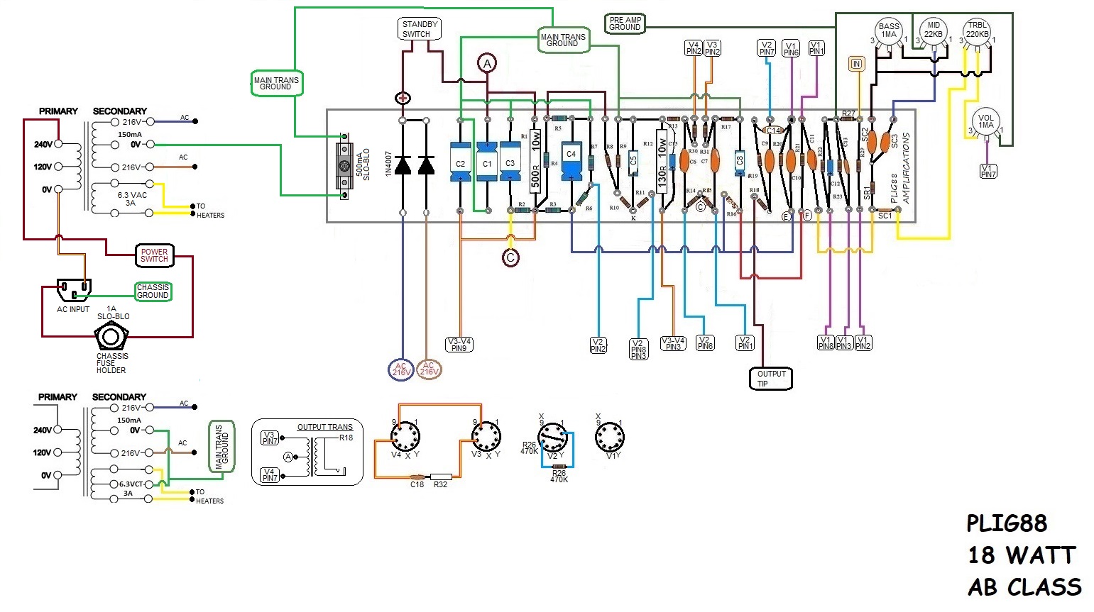

I suggest you build a project which is amply documented, say a Ceriatone or similar, including a full layout and wiring image, so you get *build* answers by looking at it.
Build it exactly as is, and only Mod needed will be adding a "direct to power amp" input jack so as to meet your needs.
Feel free to ask about it when you decided on which model to build and post images here, just in case.
Schematic is the most important part on a build, but not enough on its own unless you have built a few and can smoothly match schematic, layout drawing and actual parts on a metal chassis.

You use transformer and diodes and nothing else?I put on one ac cable the 1n4007 and on the second the another 1n4007 and those 2 cables with diode put it together

Sorry my mistake .. I forgot add 50uf cap .. now my testing trans increase volts right ( x 1.41 ) .. everything is fine .. thank you ..
Send input jack straight to P1 and call it "Volume"
Replace 5Y3 with a couple 1N4007 and lower suggested PT voltage to compensate that.
Say 220+220V secondary, not highervthan 2 x 240V, you won´t need the 5V filament winding.

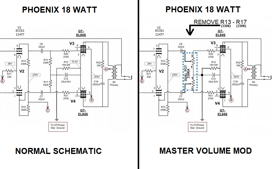

I thought of something .. to avoid the gain of the first tube. I thought of putting a master volume. so the volume of tube rename in gain… I will have the gain control to a point where my signal does not mess up and I will have the master volume .. how does it sound to you? I made the master volume based on Marshall 1974x mod (master volume by tube depot)
That pot looks backward. It shorts-out the 12AT7 at minimum volume. Yes softer, but also grossly distorted. You may need to try it the other way.
More to the point: it is inside the loop feedback. So at first it will do "nothing". When it finally takes a bite, the sound may change significantly.
Are you just over-thinking a volume control?
