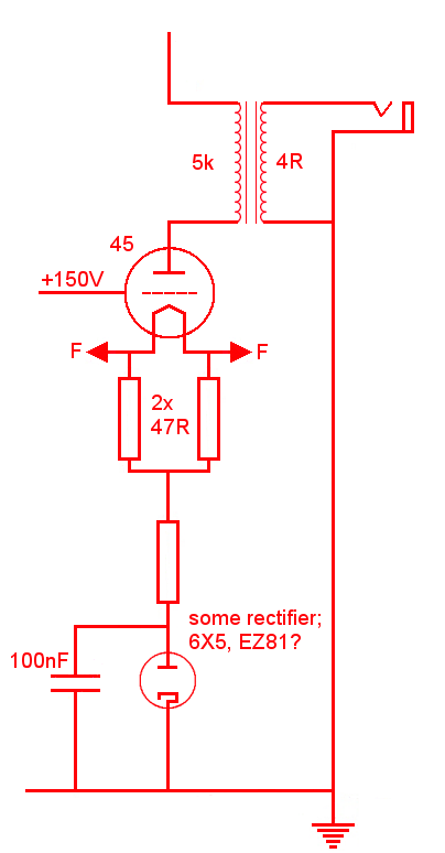

Those VR tubes got me thinking again.
So I came up with this idea, from ground up to 45 cathode:
ground -> two rechargeable batteries in parallel -> two 0C3's in series -> 45 cathode
The batteries would stop all feedback - two in parallel would ensure that the current (about 37mA) wouldn't strain them too much as it'll be hot enough inside the chassis. The 0C3 regulators would make the cathode about 210 volts positive, giving good bias if the 45 grid is at about 150 - 160 volts.
So this would give essentially fixed bias, no caps, no resistors in the cathode circuit. Also (I'm destroying my hifi reputation here) I think the 0C3's look really really nice glowing.
This would work, right? Any negative sonic effects to take into account?

OK, so you'll be running it right at the ragged edge. I'd be cautious.
If you want to keep the glow (and the noise and the voltage instability) of the gas tubes, you could use them as a reference at the base of a bipolar (or the gate of a FET), run 10mA through them, and let the solid state device handle the power tube's current.
A couple of thoughts here:
In your zeal to acquiesce to my and other people's suggestions for fixed bias you might be heading down a blind alley. I have done this and it's a good learning experience, however your initial instincts might provide a better result.
I was an early advocate of cathode based battery bias with Nicads, (10+ yrs ago) but have since changed my mind. I think this in many cases compromises the sound more than simple RC cathode bias does, and is grossly inferior IMHO to fixed bias applied in the grid circuit.
Capacitor quality and performance tends to decrease as value increases, restoring some semblance of equality seems to require exponentially larger expenditure on cathode bypass caps which is why I am such a proponent of fixed bias, notwithstanding the often significant gain in power utilization efficiency, heat generation, and tweakability. Small value high quality capacitors are easily achieved for use in ac coupling whereas larger values are not. (That said I have designed several good DC coupled two stage amps with large film caps and power resistors in the output tube cathode circuit with hum canceling - nothing over 3Wrms output however.. And I am working on another such design.. All this stuff goes to Asia.)
Sorry to belabor the above points, I guess this is one of the dangers of "design by forum.." Ultimately it is your choice to decide what works for you, take all obviously subjective design stuff (not safety related though!) with a grain of salt, and do what you want. Let us know how it works out.
- Rechargeable batteries in parallel aren't guaranteed to share the current equally. Some (many) types also have rising impedance with frequency. A single set of cells rated at 20X the continuous current flow in your circuit will essentially trickle charge and last a few years. (Anything above 800mAH should be OK.) Sanyo Cadnica are the best sounding of the bunch I have tried and have the lowest internal impedances I've seen.
- The dynamic (AC) impedance of those gas tubes in series is not as low as you would think, and they generate significant noise. You can't capacitively bypass them in a meaningful way for audio frequencies either or they will become relaxation oscillators. Dynamic impedance in these tubes might be as much as a few hundred ohms each.
- Gas tubes have a significant tolerance on the initial voltage value they regulate to. You will not know your exact operating point and it cannot be accurately predicted in advance.
Or, use them as a reference voltage for a pentode that can take the current at the required voltage.
Honestly though, I'm pretty much set on using arrays of LED's for Cathode bias. Still cheaper than a power resistor and AudioPhool capacitor, Free power on indicator, Great AC characteristics, and damn near constant voltage drop.

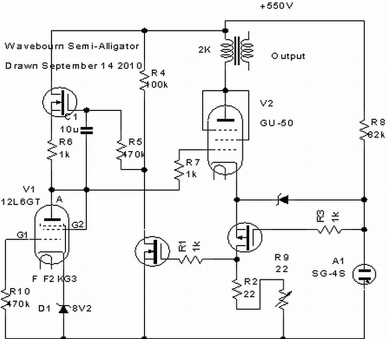

In my experience the VR tubes need to drive a current free gate/grid, any load and they oscillate like crazy. Well all mine did anyway... I ended up using a source follower in an IRF730 mosfet to stop mine oscillating.
When used in cathode there is no load for it. And it is rated for twice higher current than usual LED. However, some minimal current too keep it glowing have to be supplied by an additional resistor, to prevent shut down when an output tube cuts off, otherwise nasty clipping guaranteed.
Why it oscillates? Because higher voltage is needed to ignite it than to sustain glowing. If current is always higher than needed to keep it glowing it won't oscillate.
