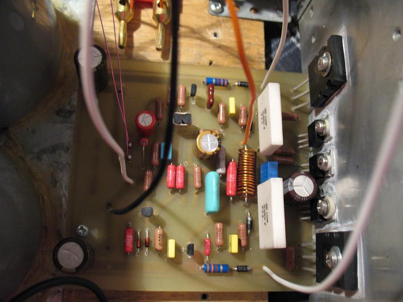

HelloI used before MJL0281A but no longer available .Unfortunately I burnt one side the amplifier .
But NJW0281 is available. You replace the MJLs with them.

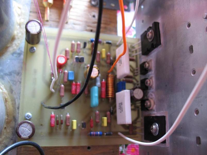

Now at least working and not bad

I have at hand the MJ15003 but that is in metal case ! Actually I'm not a fan of the MJ13003 device , I'd rather would pick MJ15024 .
Much better after my ear .
My PC board was design to use flat case power transistor .
I replaced the burnt transistor with the faster MJL4281A and I increased the emitter resistor from 0R22 to 0R68 .

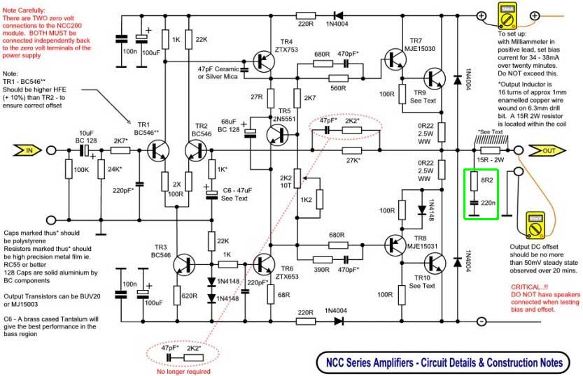

These amplifier use only NPN transistors on the power stage !A post the schematic so U can see it .

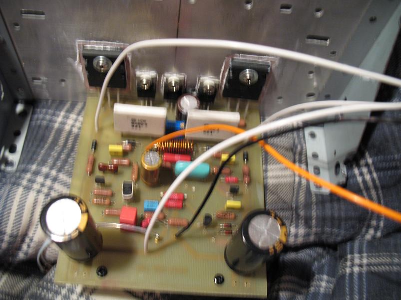

I'm more than satisfied with the MJL4281A thanks to Andrew. It does sound great , even if I would have more MJL0281A I would not go back .
The sound much open than the another side , better transparency , bass is good to .
I will replace the another side to to MJL4281A .

post 6 schematic
there are a number of component value changes I would experiment with.
Are you interested?

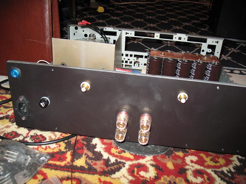

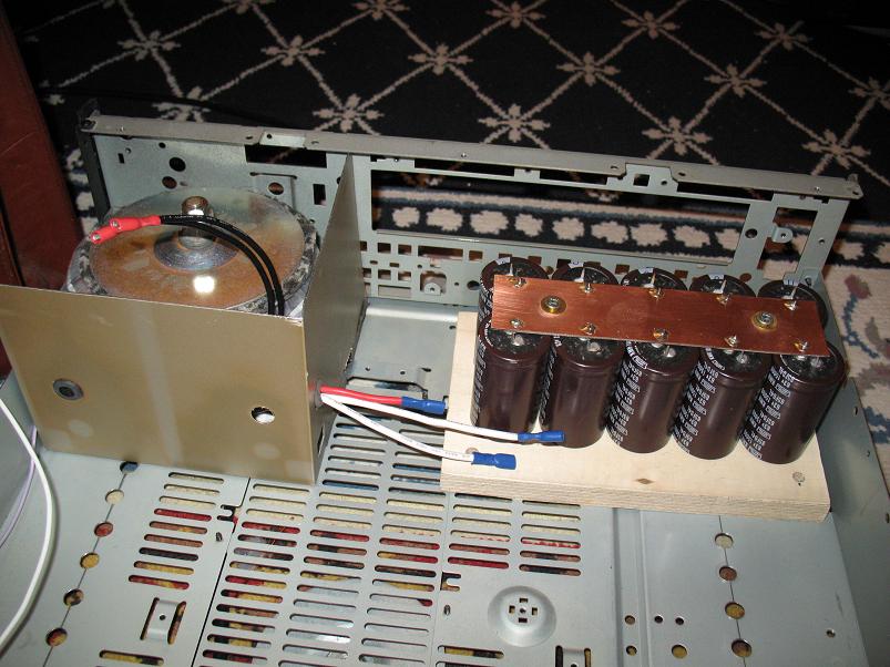

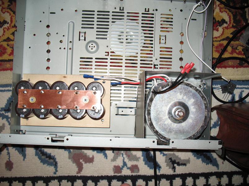

Today I started to put together the power supply , connectors etc . Until now it was built on a piece of plywood , it was easier to replace parts or work with .

If your interested, one thing I would certainly change is the 22K resistor on the second leg of the LTP. The LTP leg currents should be the same, and the Vce should also be similar. If one has greater Vce than the other, Pd will not be the same so the change in conductance with temperature will not be the same. This will lead to Vout DC drift.

The LTP transistors has different function in here .
All NAIM type schematic use in one leg 1K and on the another leg 22K .
I have at least 5 or 6 different schematic and all has like these !

this NCC schematic has used many unconventional techniques, components and values.
I suspect this makes it sound quite different from a normal set up.
You may like the designer's set up a lot and everything that you change from the design values may sound worse. So beware, these are suggestions for experiment.
47uF (C6) in the NFB. Try 150uF or 220uF. Try adding 1uF PP in parallel.
10uF in the input High Pass filter. Try 4uF or very slightly less.
100uF decoupling. Try 1000uF. Reduce the 220r rail resistors to 100r.
TR4 & 6 are passing 9mA to 10mA and TR7 & 8 are passing 5mA to 6mA.
First decrease the 100r to 51r. Check the bias through the output devices is unchanged, i.e. 0r22 current increases by ~5.5mA.
The 47pF Miller comp may need slight increase.
Measure the voltage at the two emitters of the LTP pair. Measure the difference in voltage between the two emitters.
Measure the voltage at the two collectors and the difference between the collector voltages.
This has been set up to add deliberate distortion and will give the "sound" of this amplifier.

Hello Andrew
I did tried before some of these idea but not all in one time !
When you say First decrease the 100r to 51r. you think about the resistors from the driver emitter to the power transistor emitter .
I just want to be clear on these .
Right now I use 0R68 emitter resistor do I keep that also or go back to the orig 0R22 value ?
I will set up the amplifier after your advise (only one side so I can com pair to the another side )
Thank you very much .
Cheers
Cheers
0r68 is unusually high for a 1pr output stage.
Check the voltage Vre and work out the current passing across the output.
Check the voltage across the driver emitter resistor VreD. Calculate the current through the driver.
Calculate the current through the output device.
Change ReD from 100r to 51r. Now adjust the bias so that output device bias is the same. The total quiescent current to the amplifier will be higher, about 5.5mA higher. You may find that 30r or even 24r may sound nicer, but only experimentation will determine.
As the driver current increases the driver gain increases. This may require a tiny bit more compensation around the VAS to prevent peaking on fast signals.
Hello Andrew
I made all the mod what you suggested . I set up the bias these side of the amp to the same like another side .
I do not like the result .
The sound no longer open (detailed) how it was , it is muddy I don't like at all.
I will leave it one more day to burn in a bit but I don't have much hope to get better .
I did not made any measurement ,voltage or mA , I afraid because that is how I burn the amplifier before with my DMM I made a short circuit .
Just the bias I set up and I check the offset.
I post two picture from the on side with the new set up and the old side also , you can see the difference between the two side .
Cheers
Cheers
What you got would be pretty much what I would expect. The 50 puts to much current to the output from the drive transistor on the top. With quasicomp circuit a lot of drive to the transistor directly from the driver is needed. Remember quasicomp does not work without feedback. Voltage source on top and current source on the bottom output stage. The Mission Cyrus 2 was the best of the quasicomp amps I ever heard.
If you are feeling brave there is one thing you may wish to try- change the 47pF silver mica at TR4 to a value like 100pF. That may be to much though. Maybe a 75pF there. Just a suggestion though.
